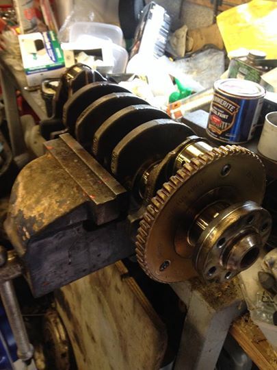

Spot the difference!
www.sas.org.uk
www.the-ace.org.uk
Offline Len
  • Posts: 16,292
Re: Len's Mk3 16v ~ The Rebel Car! New Wheel Pics Page 90
« Reply #1185 on: 26 May 2014, 16:12 »
Top one is the ABF crank from my old engine.
Bottom is a photo I found on the 'net of the trigger wheel on the diesel crank!
This why my new engine will not start!
www.sas.org.uk
www.the-ace.org.uk
Offline Len
  • Posts: 16,292
« Reply #1186 on: 26 May 2014, 16:23 »
If only I had noticed the trigger wheels were different!
And realised the significance of that!
Car would have been on the road by now!
