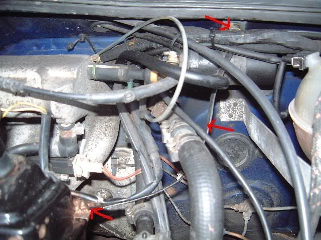

If you have not already checked it I would look at the earthing as Rubjonny said.  The coil to valve cover earth strap has a habit of going missing / breaking.  Generally a good cleaning of all earth straps on the car is good preventative maintainance.

the one you're looking for is a shunky braidsed earth cable it runs from a bracket bolted to one of the rocker cover studs, to one of the coil bracket bolts i.e. not the coil itself but the bracket that mounts it to the bulkhead :)

Sorry mate got mixed up in my first reply  :laugh: It is a while since I upset things with my MFA.  I meant connections on the coil not gearbox (which you rightly point out is the reversing light switch).  I meant for you to clean the connections from the coil with WD40.
As compensation I will take you a pic of the earth cable tonight.

Right here is the pic.
Good Luck!

Cheers for the pic mate! Unfortunately (fortunately?) it's present and making good contact so that's not the problem. I'm starting to think it's just a loose connection behind the instrument cluster now, so now I've tried all the easy things it's coming out tomorrow to give all the contacts a good clean. Lost all dash illumination on the way home tonight but it then came back when I gave the top a good hard whack, so if nothing else I'll have it off to fix that...
