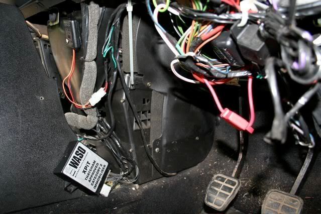

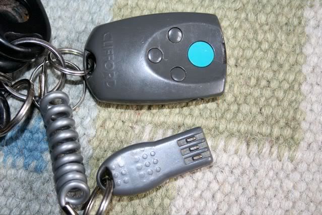

Righty then..... The Waso box is the culprit by the looks of it the Clifford is alarm only.
I would try cleaning the contacts on the immobliser keyfob to make them shiny a bit of fine sandpaper or a nail board or similar should  do it. If not I think you might have to bypass it which is a pain unless you know what your doing.
an auto electrician should be able to do that for you for a lot less than a clifford engineer who wouldn't touch the waso anyway.
If your close I could have a look at it for you.

its a long shot but i think the battery on the remote is gone. we took it out and it wont light a torch bulb. and i was thinking that if the car autoimmobilised itself or panic-killed the starter or whatever then if the battery on the remote is gone maybe it explains why it doesnt chirp or the side indicators light up, because i cant tell it not to panic cos ive got the keys?
thankyou monzablue16v. i really wish you were down the road, but im up in the borders of scotland...
do you know how i could get a new battery? it looks very odd. 12 v tiny..
will try sanding the keyfob too. so is the wazo the immobiliser part?not part of clifford? i see.

You can get them from any auto shop or halfords, it will be a 12v mini battery in that so give it a go. You should be able to arm it and then disarm it and it will work. The Waso box has nothing to do with the clifford unless someone did something fancy but I doubt it.
