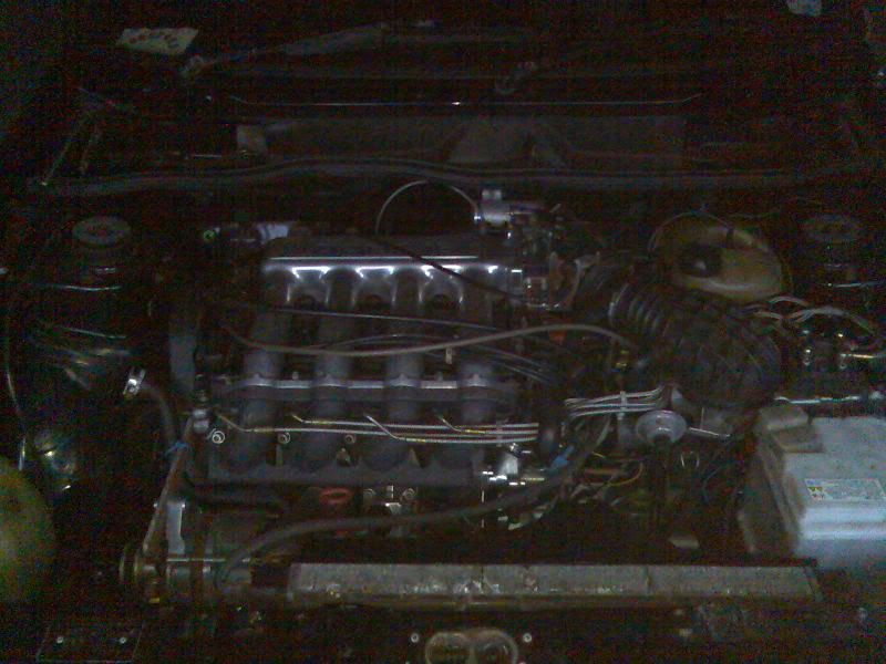

A few more pictures I took today
The Business end, it still needs a bit of tidying and the polished bits don't look so polished  :sad: but overall I'm well pleased  :smiley:
