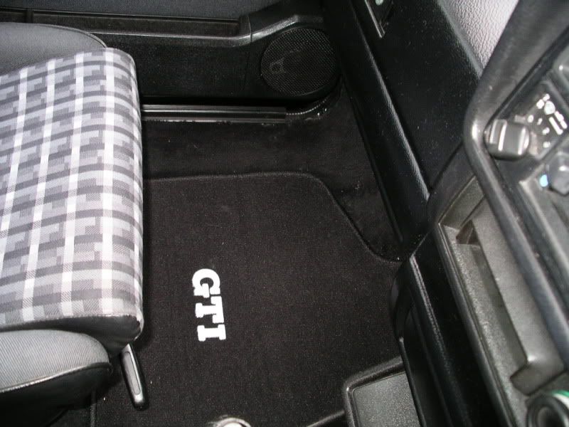

So after having a NEW full set of Deluxe black with White GTI sign matt's from JUSTMATZ sitting in the spare room from since Ed38 last year I thought I would install them at the weekend. They really do finish off the interior:cool:
