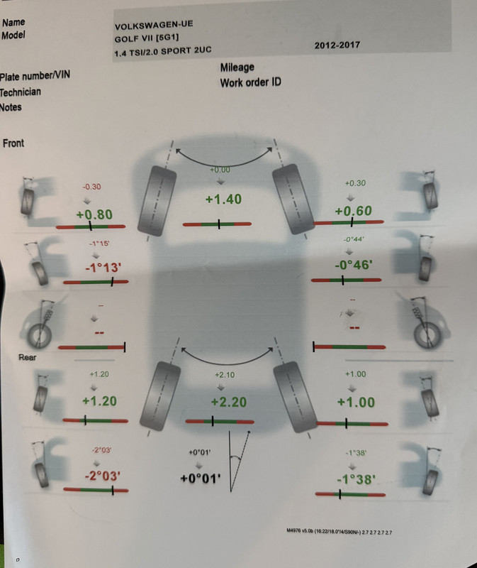

Hey everyone, just wanted to vent and see if anyone has dealt with a similar headache.
I recently took my Mk6 Golf in for its MOT. It needed some repairs ( anti roll bar ) and so needed the tracking sorted, but when I got home and looked closer at the printout they handed me, I noticed they actually ran the alignment using MK7 Golf (5G1) specs instead of the correct ones for my car. To top it all off, when I walked around to check the car after getting home, I noticed they've completely scuffed one of my alloy wheels.
On top of the visual damage, the steering now feels noticeably off and pulls slightly to the left when driving straight.
Am I right in thinking the steering feeling off and pulling to the left is because they used the wrong spec for the car?

« Reply #1 on: Today at 09:19 »
The main reason for pulling to one side is incorrect wheel alignment and the fact that the steering wheel is not correctly centred suggests poor practice by the garage. The wrong spec could have contributed to this. You don't say if it was a full 4 wheel alignment? If it was then most reputable garages will provide a printout of the alignment after that you can check. If not then suggest that is your first action. I always have 4 wheel alignment on my mk6 after suspension or tyre changes.

« Reply #2 on: Today at 09:29 »
Here is the print out
My car is a 2012 MK6 GTI.
