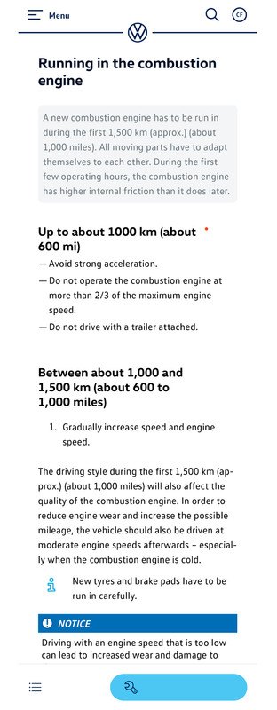

I ran mine in as per the cars owners manual.

Follow the directions in the user manual and you’ll be golden. as SRGTD says, try and avoid sitting at the same speed in the same gear for too long whilst on the motorway trip home.
