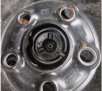

Does anyone know if a space saver from an Audi S3 will work for an 8.5Gti? (Part no. 1J0601027M)
Offline SRGTD
  • Posts: 3,957
Re: Mk 8 GTI spare wheel
« Reply #29 on: 08 May 2025, 17:59 »
The space saver being advertised at the link below also has the same part number (1J0601027M) but the ad. states the PCD (bolt pattern) is 5x100 which is the bolt pattern for the mk4 Golf and the Polo.
https://www.stevensvwspares.com/ebay_listing/370962788962
The mk5 Golf and later models of Golf have a PCD (bolt pattern) of 5x112, so assuming the Audi space saver in your post is the same as the one in the link I’ve posted, it wouldn’t fit a mk8.5 GTI.
