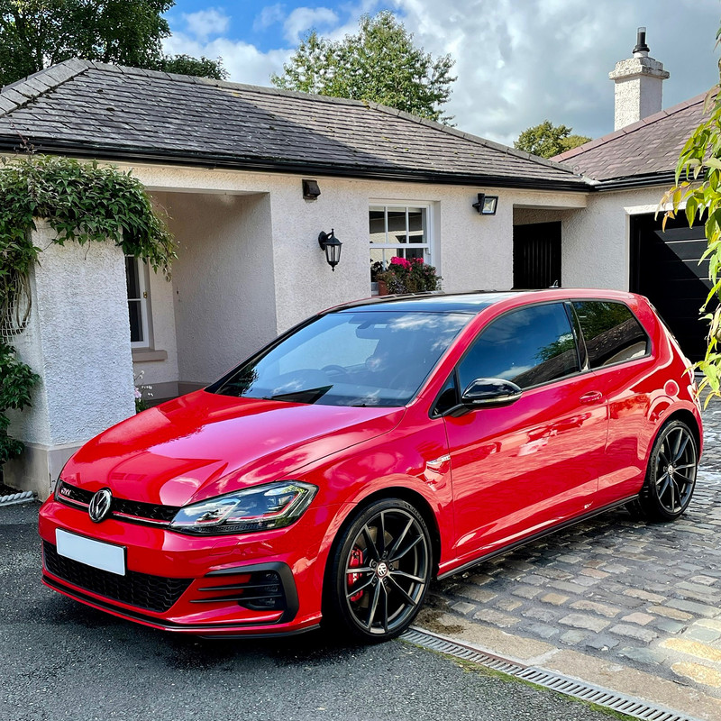

So you're a local man seeking a wheely good time, here's a few of my iterations:
Brescias 7.5J ET50 with 12mm Front Spacers and 15mm Spacers Rear 225/35R19
BBS CI-R 8.5J ET45 no Spacers 235/35R19
T-Roc / Passat Pretorias - 8J ET44 no Spacers 225/35R19
