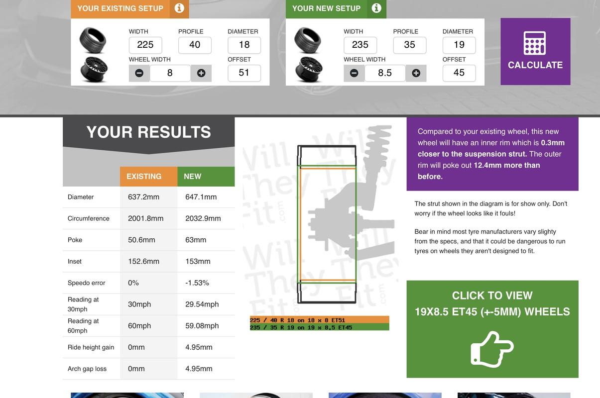

19” wheels with standard fit tyres will be 9.9mm larger overall diameter than 18” with standard fit tyres. Which is 4.95mm less arch gap and 4.95mm higher ride height. Depending of the offset (ET) they may poke out further which will also give the illusion of filling the arches more
  • Posts: 9,526
Re: Mk 8 GTI - new owner questions
« Reply #35 on: 14 July 2024, 22:34 »
The factory 19” wheels are 8J ET50 not 8.5J and ET45 as in the table above so only 6mm or so extra “poke” but I do agree that wheel offset can visually make a big difference to how the wheel/tyre combo fills the arch.
