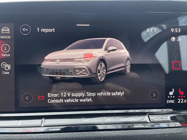

Has anybody seen this message before?? Happened to me this morning, firstly there was a long beep and message in the dash display along with a red battery icon at the bottom of the screen, the beep and message stopped after a few seconds but the battery icon remained, I then looked in the infotainment to find a stored message, [ERROR: 12v supply. Stop vehicle safely! Consult vehicle wallet.] I haven’t looked in the book as I don’t have it with me, but did look in the infotainment guides, this advises to contact the dealership, it’s going on anyway on the 4th to have the scratched steering wheel replaced so will tell them then, I’m just wondering if anybody in the meantime might know what it relates to exactly? I had been sat with the engine idling and the stop/start had kicked in, this happened about 5-10mins after it shut off, I thought perhaps it was to do with it not restarting when the voltage dropped, but that would be a yellow battery icon according to the info available in the digital owners manual, after I re started the car it seemed normal and didn’t happen again! 🤷🏼

Yeah, have done today, they didn’t seem overly concerned and just said they’ll have a look at it when it goes in on the 4th, I was just hoping someone here may be able to shed some light on it in the meantime. I did scan it, and there were many codes! but most related to lost communication in various modules, but one of them that was a genuine fault code was
NV-Energy management
Alarm triggered
Fault code:
B1802F1
There is nothing i can see online that exactly matches the above, but what I can find may suggest a duff battery! No doubt the dealership will try and charge a small fortune for a replacement if it is that.🤨
