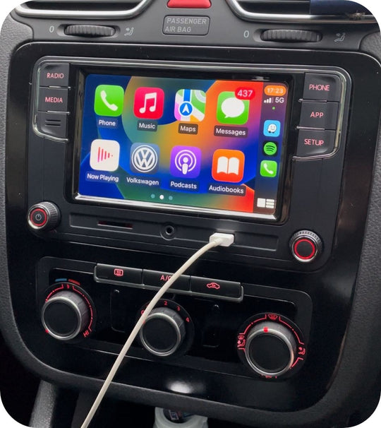

Having just got my Eddy, its got an RCD330
Looks like this;
But I want to change it out with something that has Apple car play with a way to route the wire behind the unit as my current wire just gets in the way when changing gears.
At first, I thought about getting the upgraded version of the RCD330 called the RCD330+ which comes to $479 but has more RAM and a wireless Carplay dongle! (Select Package A) but I am yet to see what that comes to with shipping/fees etc think it comes directly from China but is the cheapest option and is plug and play. Only downsides I have discovered with this unit are it has no DAB and the FAM/AM stations won't display the station names, you will only see the freq - As it is build as an OEM replacement, it also doesn't have any pre-outs for amps etc.
