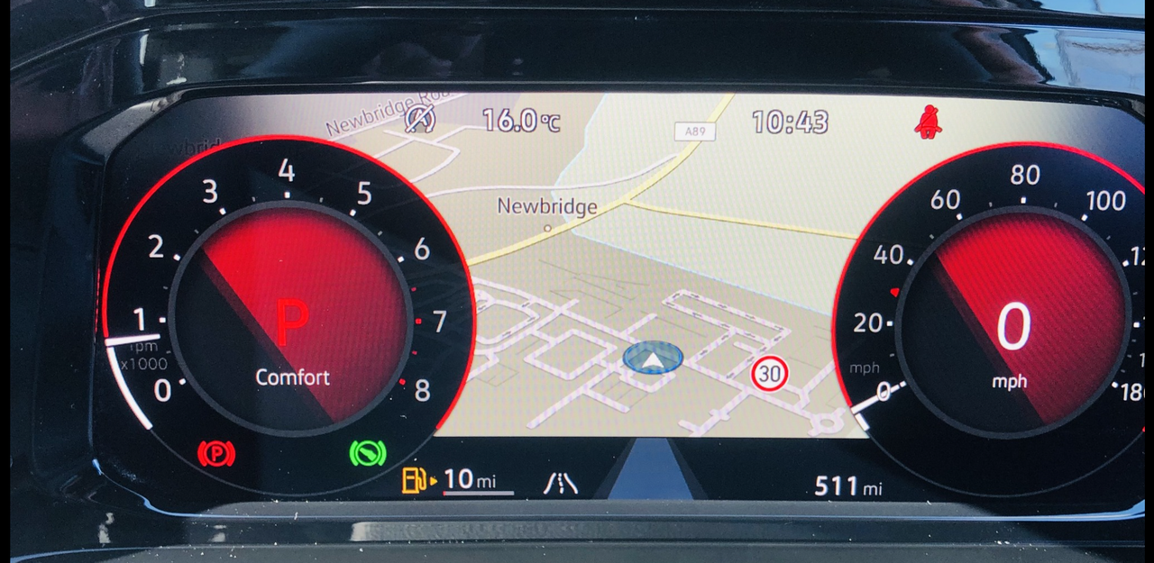

I've noticed in some dealership photos of new cars that you can configure the dash to look like this, i.e. the Nav/maps view with round speedo/rev counter either side. Looks quite nice and it isn't possible in my car as far as I know.
Can anyone on latest software (1899?) confirm whether they can get their clocks to look like this?
Offline fredgroves
  • Posts: 8,050
Re: Avon calling!
« Reply #176 on: 17 April 2023, 15:36 »
Its not software, its the display unit itself.... the newest Golfs can do it, not the older ones.
No idea why, it is just graphics in code.... but hey, VW.
