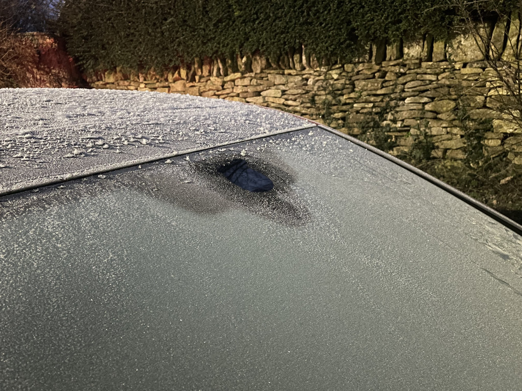

I can’t say I’ve noticed any condensation related camera issues myself, but for those that do it shouldn’t persist for long after start,  as the area around the lens has a heating element, here shown in the picture I took in January while heavily frosted.
It does but it takes a little time, especially when you get those weird window fogging conditions at this time of year.
It doesn't last long - couple of miles and its sorted.
What I'm trying to say is that other than stupid software errors, you can get other issues with the sensors.
Indeed! I totally agree, none will ever be completely bong free as you say, and neither should they be, environmental factors will always cause issues regardless of make or model, fog/frost/bright sun or dirt etc will inevitably have an effect on function, and thus at times will trigger a warning.
