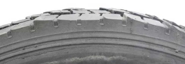

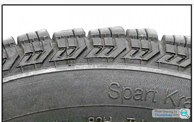

Agree, sounds like it could be the inner edge of the rear tyres wearing in a stepped, sawtooth pattern. I had this on my mk5 Golf and it did sound like worn wheel bearings.
@AMG01; if it is sawtooth tyre wear, you can often see it. If not, you can probably feel it if you run your hand around the inside edge of the rear tyres.
You can see examples of it in the pictures below;

I had the same issue last year. Road noise was terrible and assumed the worst. Popped into ATS just to check any issues with the tyres, Put the car on the ramp and sure enough both rears were stepped. It was on the inside so could'nt really see anything. Plenty of tread remaining and always checking my pressures so my thoughts were mechanical. Changed them for new and bingo I can hear the wife whinging again. :laugh:

Errr yes it definitely does!
And likely as not it will occur before the tread depth is anywhere near the legal limit - the car is super light on its rear tyre usage.
I saw problems at around 55k on both of mine - the tyres probably could have lasted another 20k except for the insane noise.
