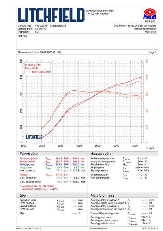

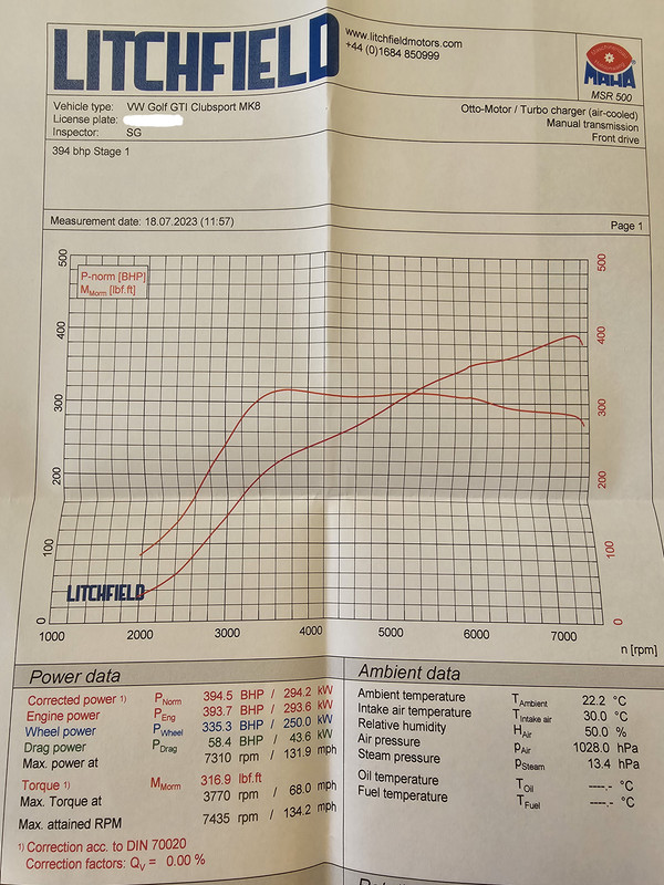

So I've had a few final tweaks at Lichfield again today, as I wasn't fully satisfied with the 364bhp dyno result from the TVS ECU tune last month. I've been back in between for other TCU tweaks, but those were very minor.
It's now reached 395 bhp at around 7,300rpm, the torque didn't climb above 430nm though. Not sure why I didn't see a higher climb in torque, or whether peak power is ideal at such a high rev count. I didn't think to ask about it until later, as I was too wrapped up in the higher bhp result.
Dyno run attached. Anyone more in the know than me care to share their thoughts on the results? Cheers

Yes I had been comparing their example graph online to the one I've had. My bhp pushes a touch higher, granted at an 800rpm higher rev, but my torque takes a 40nm hit.
Both my torque and bhp climb considerably faster than their's in the 2,000-3,500rpm range, but the torque tapers off after that point. The bhp also has a much more gradual climb after that, all the way up to 7,300rpm, whereas their's cuts at 6,400.
From the stats I don't really know what to think of it.. It is worth mentioning that my map isn't identical to their's though. As their's is their own ECU tune, with TCU enhancements.
  • I had a TVS stage 2 ECU and stage 2+ TCU, with recommended settings, which included raising rev limit.
  • Then the TCU was tinkered with to remove the up/downshift and kickdown in manual, to have the rev count hiked slightly, and they did also try to remove the hard cut rev limiter, but said they couldn't do it.
  • Then the ECU was essentially remapped again yesterday with their own tune, that they got around 385bhp for initially, but continued tweaking it until it hit 395.
I feel the tweaks to gain the bhp may have sacrificed some torque, and honestly I'm not sure whether I should be happy with that (and the high rev count peak power) or not.

Called Litchfield and spoke to the chap who tuned it. He's explained the high rev is because of the TVS TCU tune, and the rev limiter being set that far above the 6,500rpm stock their test CS ran on. I spoke to Edd moore about it as well, and he said that reaching max power at max rpm is absolutely fine, so that's that sorted.
The torque he thinks is a mistake, likely the Dyno not calibrated properly. When I'm local next he said to pop in and he'll run the dyno again for me free of charge.
He did send me another graph through, comparing what it came in with (TVS ECU Stage 2) vs how it left. There are torque gains there around 4,000rpm of say 15lbft, so assuming the 346lbft figure i had from the previous dyno is accurate, that should mean i'm likely looking at 490nm+.
Which isn't jaw dropping, but as with the 395bhp, it's a hair more than Litchfield's own stage 1, so that's okay for stage 1.
