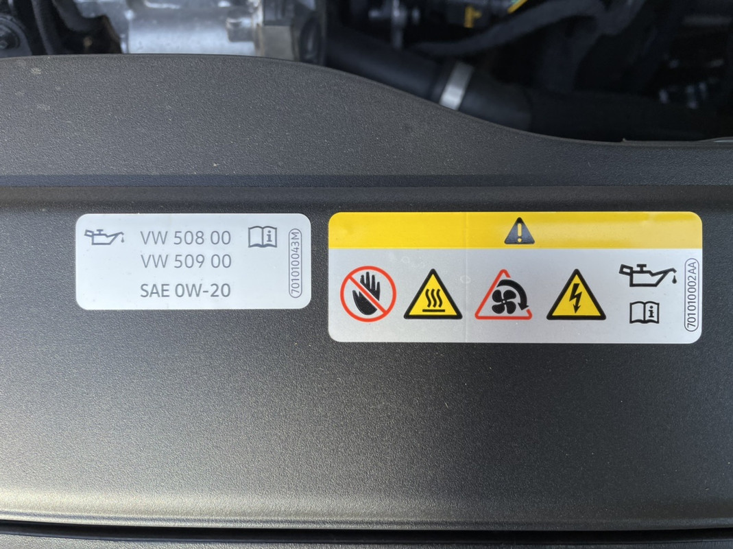

Here is a pic of the sticker under my bonnet (2022MY 245ps UK), as long as they are accepted as suitable by VW different grades of oil will be ok, it’s the spec that’s most critical, (such as 508.00-509.00 or 504.00/507.00)

Wonder if that’s an MY22 change? Mine is a MY21, first oils service was June this year 0W-30 used.

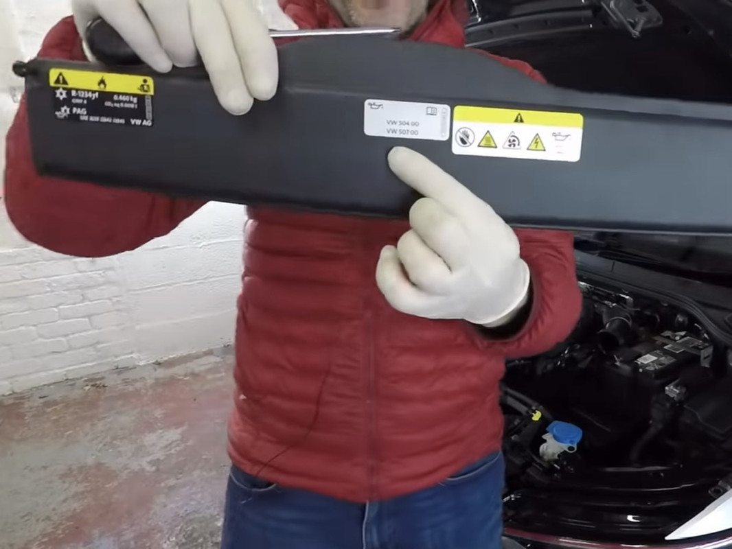

The plot thickens! 🤔, it was my understanding that late build Mk7.5 GTI’s used 0w-20 508/509, I find it hard to believe that between 2019 and my own car that they used a different spec oil for a short period, but, I had a quick look back at the VolksWizard intake video where he takes off the intake cover and points out the oil spec, it does indeed state 504.00/507.00, there is no grade mentioned on the sticker though, it could well be that it is a clubsport (and possibly R) specific spec.
