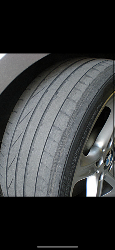

Sorry, let me provide more information. I have attached a photo from the internet that looked exactly like my front tyres. However, the wear was on the side of the front two tyres. Is this likely to toe angle or the camber from dropping 25mm front and rear. The weird thing was that both tyres had evenly worn tread across them, apart from the inner side, like displayed in this pic. Would dropping my car 25mm cause that much of an issue to the tyres providing I have had them properly aligned. After my research I’m leaning towards toe angle rather than camber, as the camber would have to surely be ridiculously angled to cause that damage? Any thoughts from anyone would be welcome to have a guess at the cause, because I don’t really wanna spend £600 getting suspension with adjustable top mounts?

If what your saying is the wear on your tyres looks like the pic but on the inner edge then that could be caused by excessive toe out caused by lowering and not readjusting the toe angle.
A 25mm drop would indeed increase the neg camber, but not by much, and certainly not enough to do that.

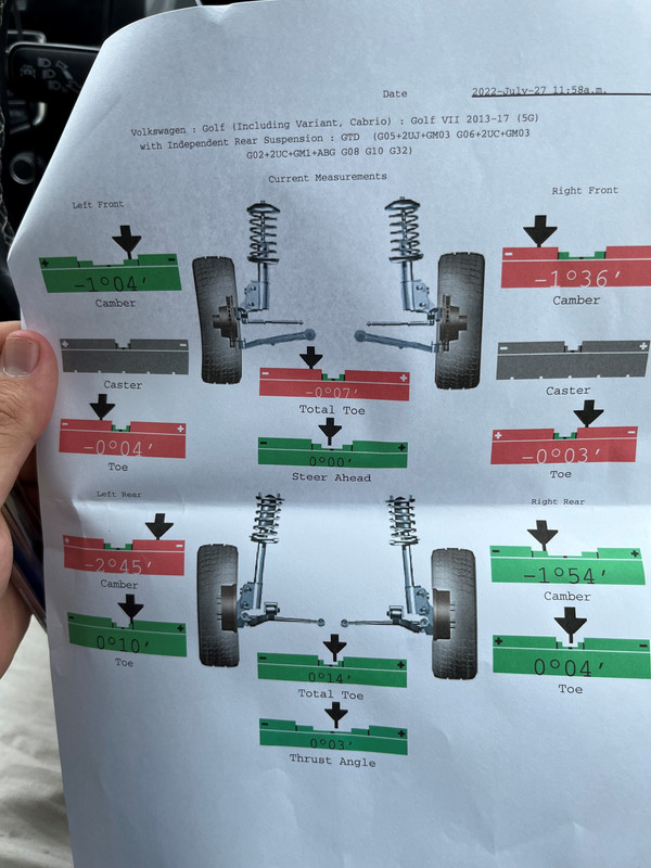

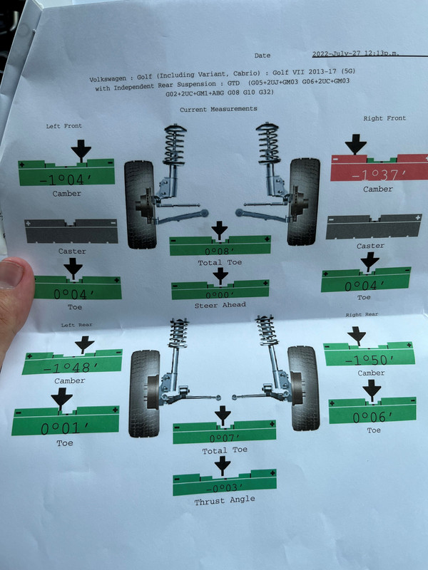

Hi, to anyone that is interested. I went to ETS, as they have a hunter alignment system and only cost £37.50 for the front axle. They said it was toe out issues. I am not clued up on the results, but apparently they are fine now. I have attached the results... Do they seem okay?

You had a bit of toe out and now you've got a whiff of toe in.
-41 +-30 minutes is the tolerance for camber, so 1 degree 11 minutes is the maximum tolerance, hence the right front is highlighted in red. (60 minutes = 1 degree)
Perhaps could've tweaked the camber angles by nudging the sub-frame across to the left a touch, it just would've evened them up a little, about 1 degree 20 minutes either side.
However this would have been a bit (alot!!) of trial and error and £37-50 only buys you so much time, i guess for that money its purely a front wheel toe align and adjust although it looks as though they might have tweaked the left rear and brought that into spec.
Hope some of that makes sense??

Thanks! When I drove home last night the wheel was pulling to the left ever so slightly, I'm guessing the readings could be the result of the wheel pulling to the left? Checked tyre pressures and they were only 1 psi different. So, I'm gunna take it back today to get it looked at.

Those toe readings are bloody good, 0.04 minutes each side, with a total toe of 0.08 is spot on.
spec is .10 minutes toe in +-10 so your pretty much bang on.
Cars tend to pull slightly to the left due to the camber of the road.
The trouble is with a front wheel alignment only, you can get the front to be spot on but it will always be fighting the rear if thats out of spec.
The rear alignment looks good in your case but thats not to say the rear axle centre line is parallel to the front axle centre line.

Yeah, I don't think this pulling to the left is the road, as the steering wheel is off centre. I know that the road does play an affect, but when driving in a straight line the wheel is visibly off centre
They said "Your friend is 100% right haha" and they have said to bring it back down whenever and they will have a look and adjust it for free!
