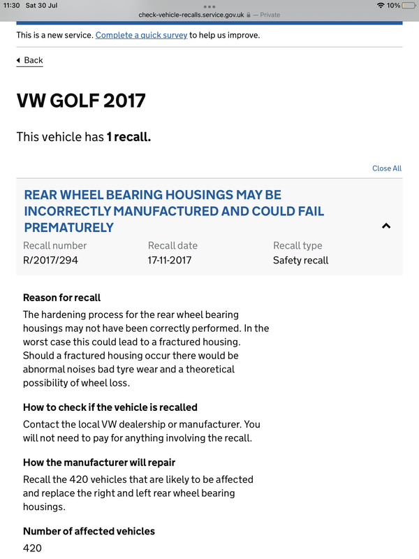

According to gov.uk website, there appears to be only one safety recall on the mk7 Golf relating to the rear hub assemblies and it was wheel bearing related back in 2017 - see screenshot below. There are other safety recalls listed over the life of the mk7 / mk7.5 Golf but I couldn’t see any others that relate to the rear hubs.
The part of the ‘hub’ that corrodes that can be seen is the centre section of the brake disc rather the hub itself. Brake discs are usually made from cast iron, so if they have minimal protection applied when they’re manufactured, then they’ll corrode. It doesn’t just affect VW; it’ll be fairly common with other car manufacturers too.
It’s been discussed many times over the years on the forum and as @joe6 has suggested, removing the wheels, rubbing down the centre section and painting it (a couple of coats of something like Hammerite) should give 2-3 (or more) years of protection.
