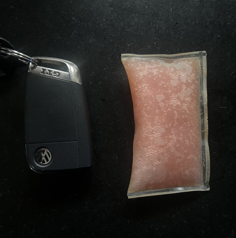

I got a brand new lease GTI back in the day when they were on a crazy £99 per month deal. Took the train to go and collect it and on the way home the heater would not get warm. Brand new and they wanted to take the dash out! In the end I got them to swap it for another brand new one.
Gives me nightmare thinking about having your dash removed and handing over 1k for the privilege! Finally got around to it:

Like others have suggested before: I clamped the pipe coming out of the reservoir and then used some needle nosed pliers to manoeuvre the bag out. To be honest it took me longer to actually open the stubborn filler cap than it did to remove the bag.
