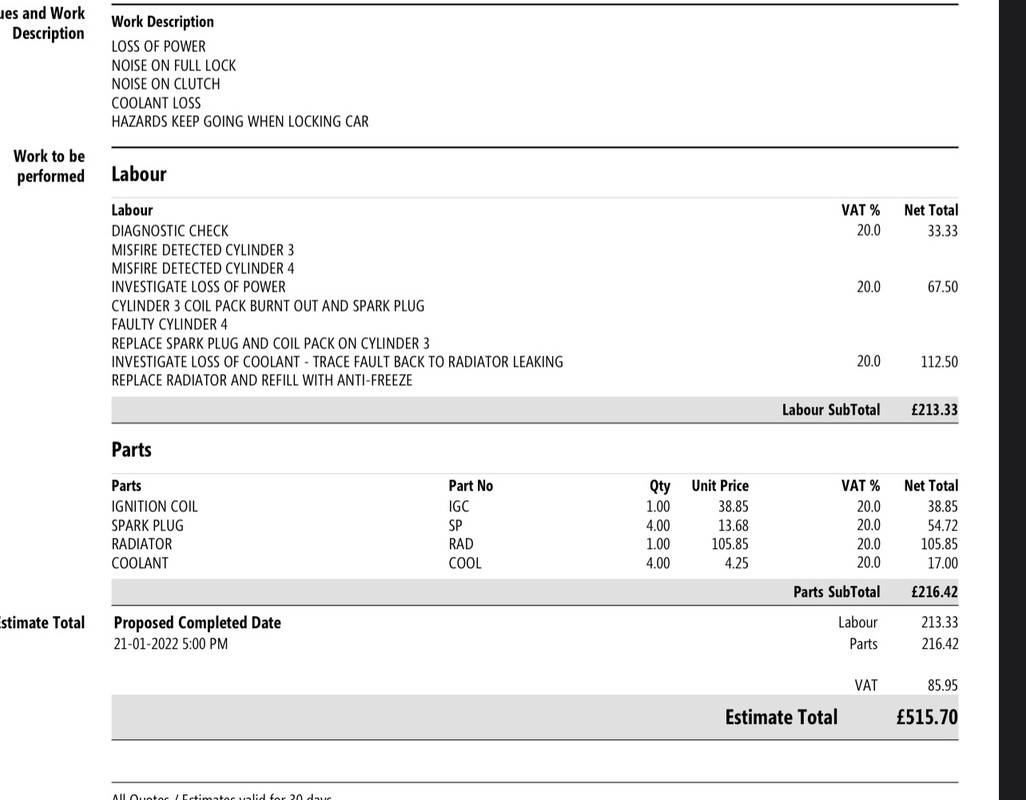

Just dropped my lads off to school and on my way home the car lost all power and the engine felt like it was gonna jump out of its bay ! Left it to idle and opened the bonnet engine was shuddering - managed to limp it to a garage and they have advised it’s possibly the coil pack ?
Any advice if this could be a can of worms opening for further issues to arise ? Thanks (don’t seem to have much luck with this car at the moment) I am thinking of px it for a mk7 /7.5

Hi Yes they have plugged it in and diagnosed a misfire in cylinder 3 burnt out coil pack and cylinder 4 dodgy spark plug also noticed coolant low so poss leak in radiator too

Replaced all of the coil pack now and new plugs
