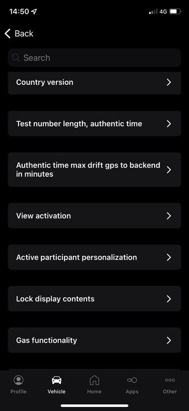

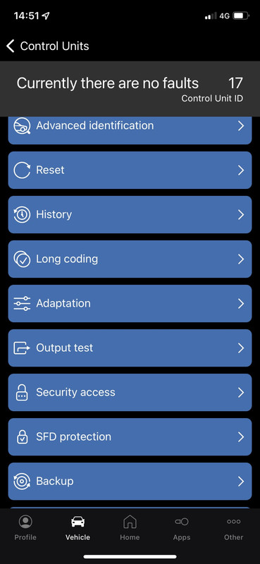

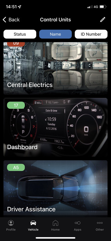

Pretty sure this is how I got the R display on OBDeleven
Press 17 dashboard
Then press adaptation
Then view activation
There are 16 views and I activated them all
Slide to write
They don’t all actually activate but I gained the R display and a couple of others.
Think it was either view 8 or 9 for the R display

Thanks a lot Dave1rs, I got this to work  :cool:

The GTI logo just appeared for "free" when I enabled that display. I didn't do anything extra other than activate "View 8" (I think) in adaptations.
