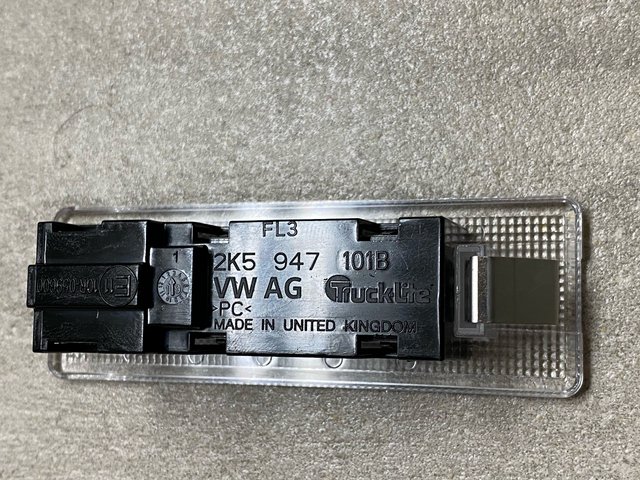

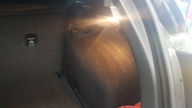

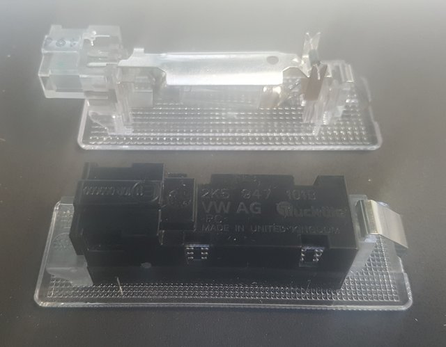

Offline madstaff
  • Posts: 709
Re: Luggage compartment lamp
« Reply #9 on: 20 October 2021, 14:09 »
Fits and works perfectly. Just like it was meant to be.  :smiley:
2K5 947 101B. about £15 from your local TPS.
LED top
LED bottom
Old festoon lamp
New LED lamp
