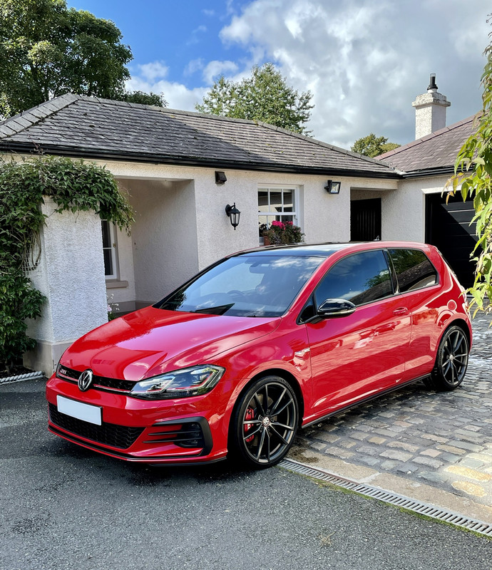

Make your life easy, a few sprays of Gyeon WetCoat every couple of washes and rinse it off, and some Polish Angel RapidWaxx for when you want to be a bit more hands on, this is what I tell my clients.
Below is my Mk7 after a bit of Koch Chemie Qf (Quick Detailer I use).
