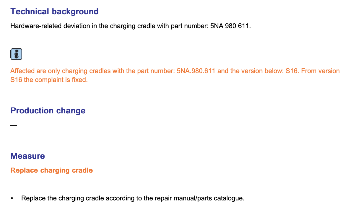

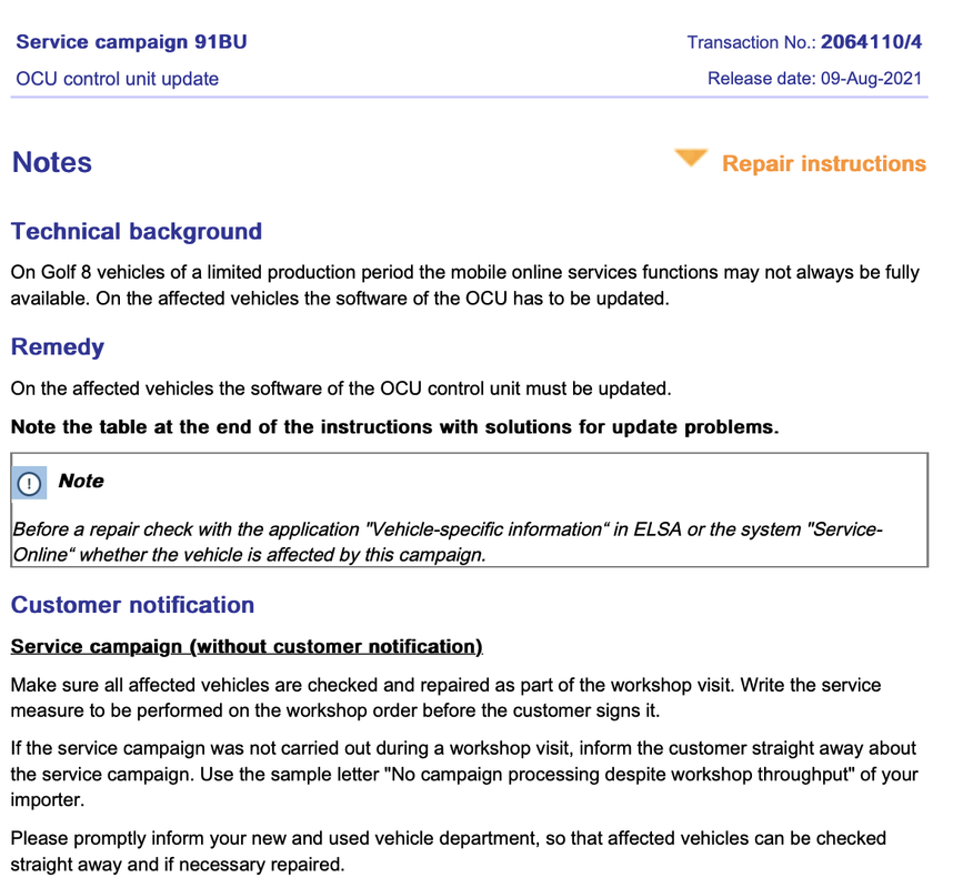

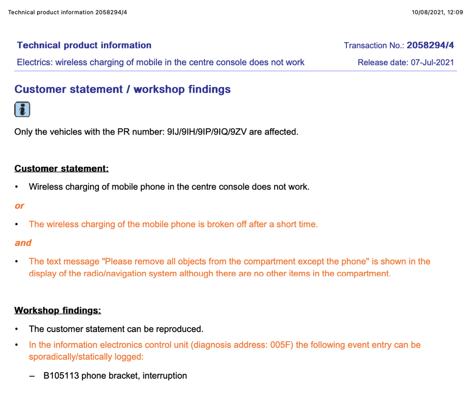

There is a known issue with some cars and wireless charging issues, as shown below, as well as a service campaign 91BU for issues with the SOS/online connection issues
