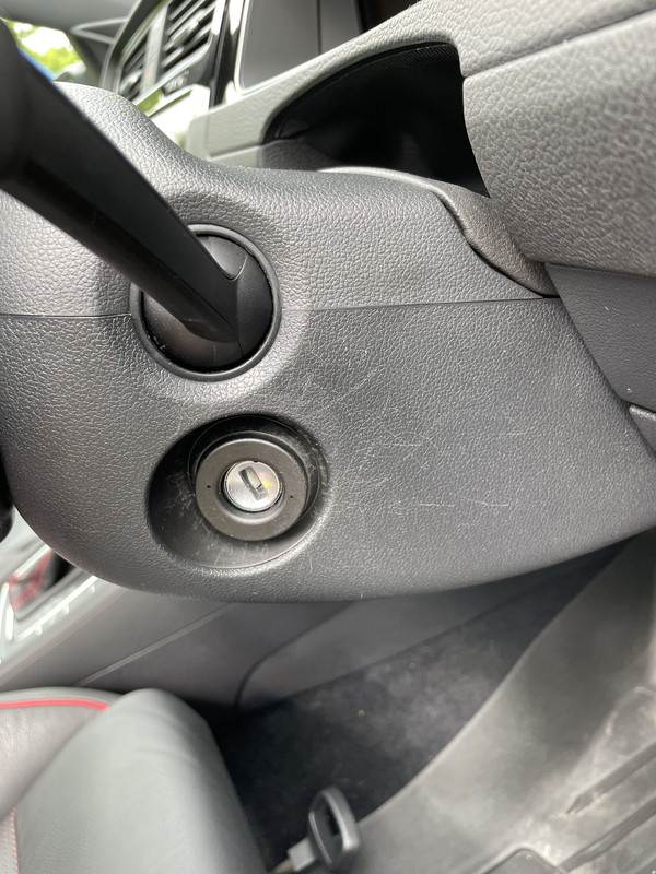

So just two screws and don’t have to take steering wheel off.  That’s good news.
Just need to source the part now.
Thanks for your help.   Much appreciated

Looks like it doesn’t have screws behind steering wheel on a 2013-2017
Part number 5G0858566F

Thanks for pic , picking car up in the morning.  White/silver 245 pp.
Will take a look then at lower column and see what’s going on
Cheers   You been great help

You'd need to double check the part number if it has keyless entry or normal entry with an ignition barrel. Be best to just ring a Volkswagen parts department and get them to use your vin to find it. I need to do the same job but couldn't be bothered taking the steering wheel off.

how badly scratched is your plastic
Offline willni
  • Posts: 1,478
Re: plastic part around key ignition badly scratched
« Reply #15 on: 08 June 2021, 11:11 »
Badly enough, ideally there would be no scratches.
Offline nunchuck
  • Posts: 43
« Reply #16 on: 08 June 2021, 11:19 »
will they polish out do you think ?

Any attempt to polish out the scratches would also polish away the texture of the plastic and will, IMO, look far worse.
I dont think steering cowlings are particularly expensive.
They're around £70-85 for both pieces from memory. A heat gun a grain pad would fix it, but it's in a location with a mix of materials and key electrical components so personally wouldn't try it and if I were removing it to do it I'd just buy the new cowl.

yes replace would be good idea and dont mind buying one , its taking steering wheel off is bothering me
might ask vw garage how much for parts and labour  ?
