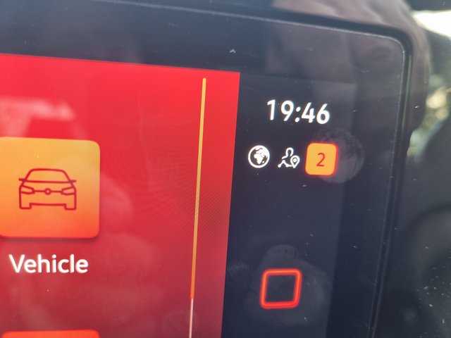

Does anyone know what the number on the Infotainment display, next to the Internet globe means? I can't find any reference to it in the owner's manual.
It's probably something simple but I just can't fathom it out. Sometimes I get in the car and it's a fig 1, sometimes 2 and sometimes 3. There appears to be no rhyme nor reason for the change. It's showing a figure 2 in the attachment.
Please can someone put me out of my misery.

Messages... 2 messages for you to read. Click on the number and it will show you what they are.
It's probably telling you that streaming media is not available, because you've not got an Internet connection setup (either a paid plan on the esim or a WiFi hot-spot on your phone).

Thanks Fred. See, I knew that it would be straightforward, it's just that I hadn't a clue what it was telling me!
I did have an e-sim account and a Wi-Fi hotspot connection, although the dealer update I had the other day (from 1788 to 1803) seems to have disconnected them and deleted my Alexa account, so that's another job for me tomorrow, setting all of those up again.

What did the two messages say? It might not have been my guess... The guess was based on what mine b!tches about when my phone fails to connect to Bluetooth and until that happens my hot-spot on my phone doesn't enable.

Its messages.  Beware though that once you've seen them, the car will never let you see them again.

I decided not to wait until tomorrow and much to my neighbours' amusement I sat outside in my car for an hour tonight and worked through the issues.
The two messages were updates (including the reinstallation of Alexa) which wouldn't completely download, for some inexplicable reason. Eventually, I figured out that it was stuck in an eternal loop and I applied the traditional solution of switching the Esim connection off and on again, and that did the trick. Both updates instantly downloaded and installed, which means Alexa is now up and running again, via the Infotainment System.
I don't know if it is related but, since the dealer update a few days ago, the Shop menu display tells me that I don't have an active Esim contract, but elsewhere in the Settings menu, under Data Connection, the Infotainment System confirms that I do have one. Perhaps, it will sort itself out and repopulate the data in the Shop sub menu in a few days?
