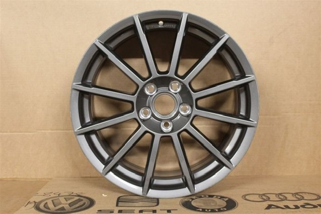

« Reply #45 on: 08 May 2021, 09:52 »
Will 18s prets or Brescia look small on golf ? Dedate on goin in head :whistle:
not with the slightly lower offset you get on reps they won't.
The genuine VW version of the 18” Pretoria alloy has an offset of ET51 (7.5J x 18”) and is available in either silver or black.
Part numbers;
Silver 5G0071498A88Z
Black 5G0071498AAX1
Alternatively, if @VW80 wants to stick with genuine VW alloys, the 18” Rotary is an alternative (part no. 5G007149816Z). This is also 7.5J x 18” with an offset of ET51. Comes in an anthracite painted finish. I had these on my mk6 GTD.
https://www.volkswagen.co.uk/owners-and-drivers/accessories-and-merchandise/accessories/5G007149816Z/18-rotary-alloy-wheel-anthracite
@Vw80; your existing Austin alloys are 7.5J x 18” with an offset of ET49, so the genuine VW 18” version of the Pretoria (and the Rotary) will be tucked 2mm further under the wheel arch.

« Reply #48 on: 12 May 2021, 13:46 »
Part numbers;
Black 5G0071498AAX1
I run these rotary alloys as my winter alloys here in Ireland on my Mk7 Carbon Steel Grey. They suit the MK7 very well and are so much more durable than the diamond cut finished wheels. I have four sets of wheels tho as i get bored quickly  :whistle:
