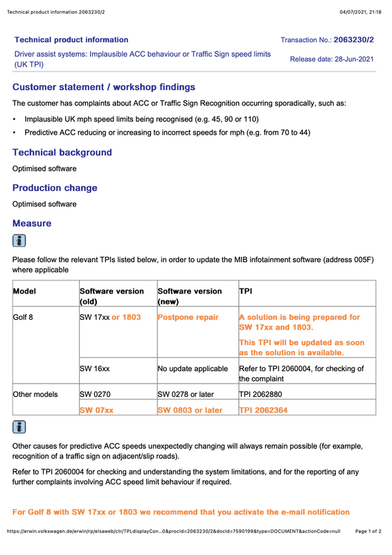

TPI is a list of specific repair and warranty instructions for dealers to follow - they basically set out a technical issue, the symptoms, how to resolve or to hold off a customer complaint, and (importantly for a dealer), how to account & charge VW back for the time/labour/parts, etc
For example,
« Last Edit: 02 December 2021, 13:44 by phope »
