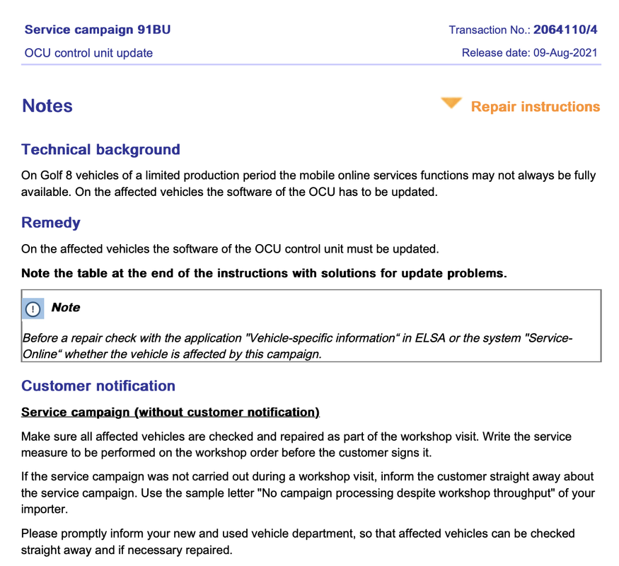

There is a separate software update campaign under reference 91BU for certain Golf 8 models and online functionality - see attached - perhaps enquire at a dealer to see if your specific car is included in the scope.
