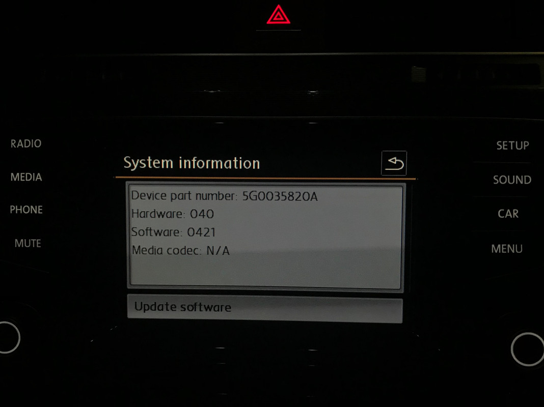

Some of you may have seen in my other thread that I purchased a 2013/2014 MK7 GTi last month and I am having an issue with the infotainment screen. Basically when I first start up the car it has a mind of it's own - starts opening lots of menus, the button animations at the bottom of the screen keep popping up as if there was a hand near the screen, it changes my radio station presets etc. I'm really gutted since I can't see how the garage would care about helping me fix this, not to mention I bought it from a garage 1hr30 away. I imagine the repairs easily running into the hundreds to fix this if it's not an easy fix like an update.
I'm hoping a VW software update may fix this and just wanted to know how up to date the software I am running is in the picture below. My other ideas in order are - Do a factory reset, VW software update (not sure if/how much this would cost me), look into a screen replacement, finally look at replacing the actual 'brain' of the system as someone said in the other thread.
Any help or advice would be hugely appreciated, thanks!

To do a firmware update you need someone with ODIS (dealer software) and a license, and pay them for the log in,
Changing the unit inside the glovebox is a balls ache as you need to get rid of CP and then get it programmed to have all the features your current one has,
Changing the screen is fairly easy but I’d say expensive
Isn’t a factory reset just pressing a couple of buttons?
Personally if it’s under warranty I’d take it back
Offline Carmyster2006
  • Posts: 3
There is a recall for infotainment, just ring vw dealer give them chassis no and they'll tell you if your eligible. Its a software update

So I've done a bit testing and everything seems to point towards a faulty touch screen. When the temperature is a little colder and as the car is warming up I assume the screen is expanding and contracting from the temperature change and causing the screen to think someone is pressing it, therefore opening looooads of random menus and sometimes even saving radio stations to different preset numbers. It's a right pain!. But as the temperatures have been a bit warmer over the past week or so it hasn't been doing it so much. As soon as colder weather comes round again all the issues will be back.
Contacted my local VW and eve they said issues with these are common. There does seem to be a software update for it but my local VW dealer charges £60 for the privilege of plugging something in and hitting a button for the update.
The cost of a new touch screen from VW is £760 inc VAT and that does not include fitting.
I got another quote from VW for £2,900 or £2,000 if I exchanged my old infotainment for a new one but I assume this price is for the whole system and not just the touch screen where the fault seems to be.
