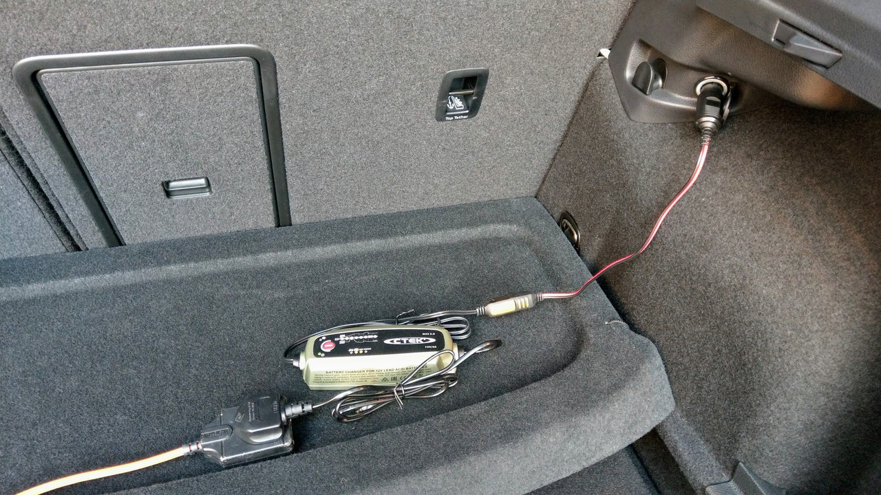

Excellent choice of charger there Bren, may I recommend you also buy the cigarette lighter socket lead https://www.ctek.com/products/vehicle/connect-cig-plug and then make your sockets permanently live by moving this fuse slightly. Makes life much easier to put the battery on charge without having to open the bonnet.

Mine's on charge now...  :smiley:
