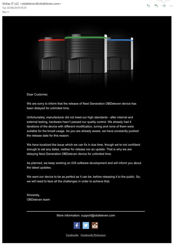

iOS is now delayed indefinitely apparently.
Yup. I received the update email last week. No dates or anything other than “delayed for unlimited time” and all products removed from their website.
As somebody who doesn’t own anything android I was relying on the new ‘next gen’ appearing soon, but I’m now back to square one and trying to find the easiest way of getting the Scandinavian lights activated before winter arrives.   :huh:
The email I received:
« Last Edit: 25 August 2019, 11:13 by kmpowell »
I saw this too, bit disappointing really. If you're around manchester at any point I'd be happy to help with scandanavian lights though.
