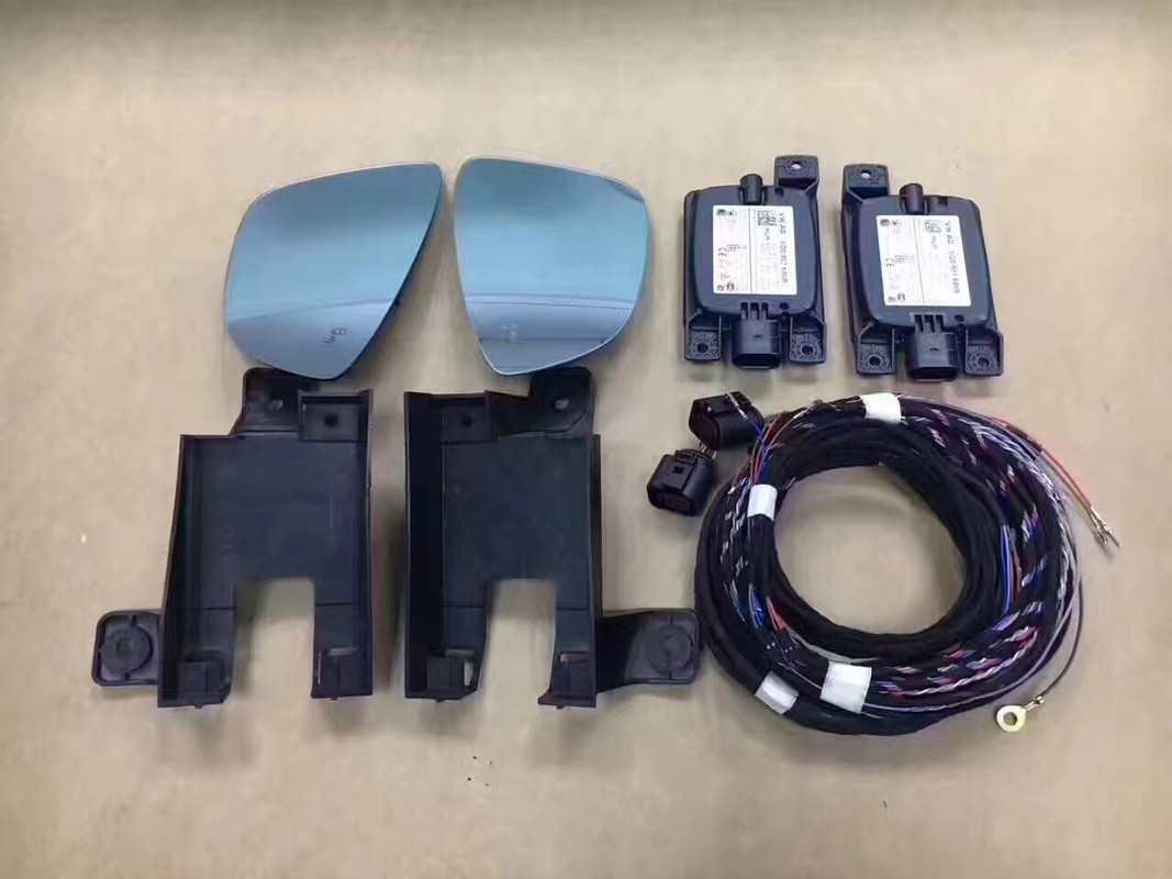

The fitter told me it's just a case of ordering UK glass, and that's the only difference in teh hardware, but for those of you that have it can you confirm which side the dotted line is, passenger or driver? :)
The kit required is as follows:
2x lane assist mirror glasses
2x module brackets (to go in the rear bumper to hold the radar modules)
2x modules (5Q0-907-686-B and 5Q0-907-685-B)
and 1x cable harness
If you have the Highline reverse camera you also need a module that allows rear monitor when parking also.
