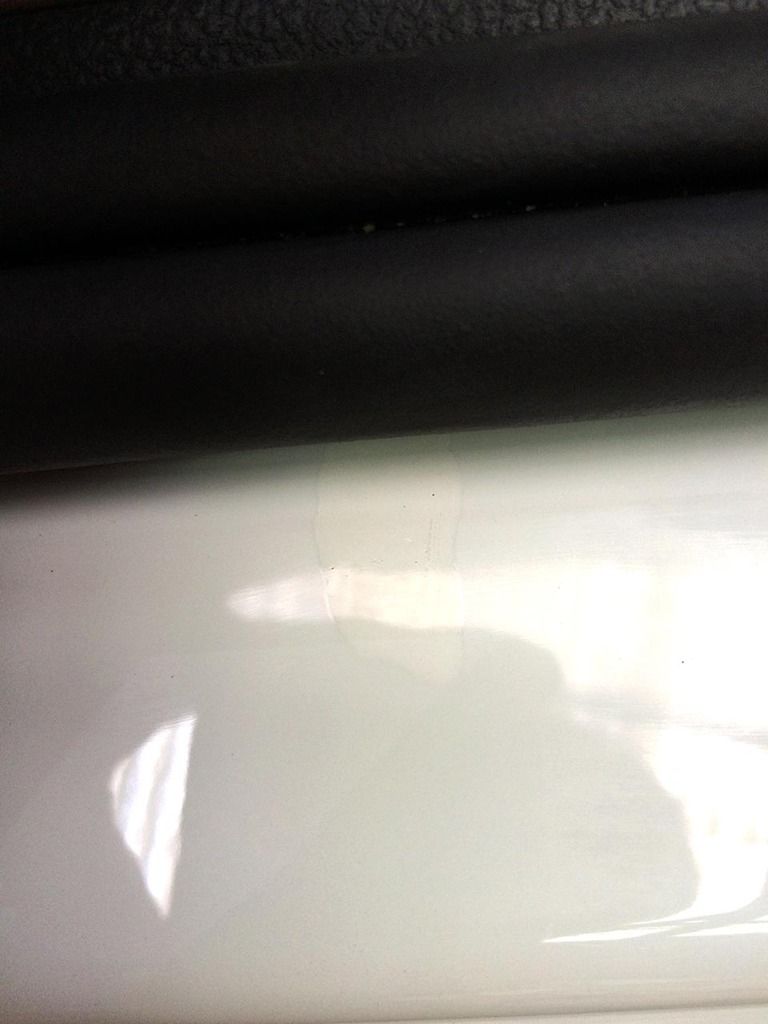

Greencode, maybe a silly question, but have you actually tried the paint on your car in the stonechip to see what it looks like? An area of paint applied to what looks like a white plastic lid in your photo isn't necessarily the best test. If you'd applied it to a black lid, it would've looked much 'whiter'.
With the Chipex kit, if the colour match isn't good on the car, the paint you've applied can be gently removed with the blending solution.

Hi. No, but the Paints4U is a similar poor match and this is what that looked like on the car

Interesting that the touched in area on your sill (Paints4U paint) doesn't look at all grey like the paint on the test patch on the plastic lid, even though it's not a perfect colour match (looks a slightly yellow-ish white compared to the original Pure White paint).
To my eye, on your plastic lid test the Paints4U paint looks to be a shade darker than the Chipex paint. I don't think you'll know how good a colour match the Chipex paint is until you use it on your car. If it is a shade lighter than the Paints4U paint, it might actually be a good match.

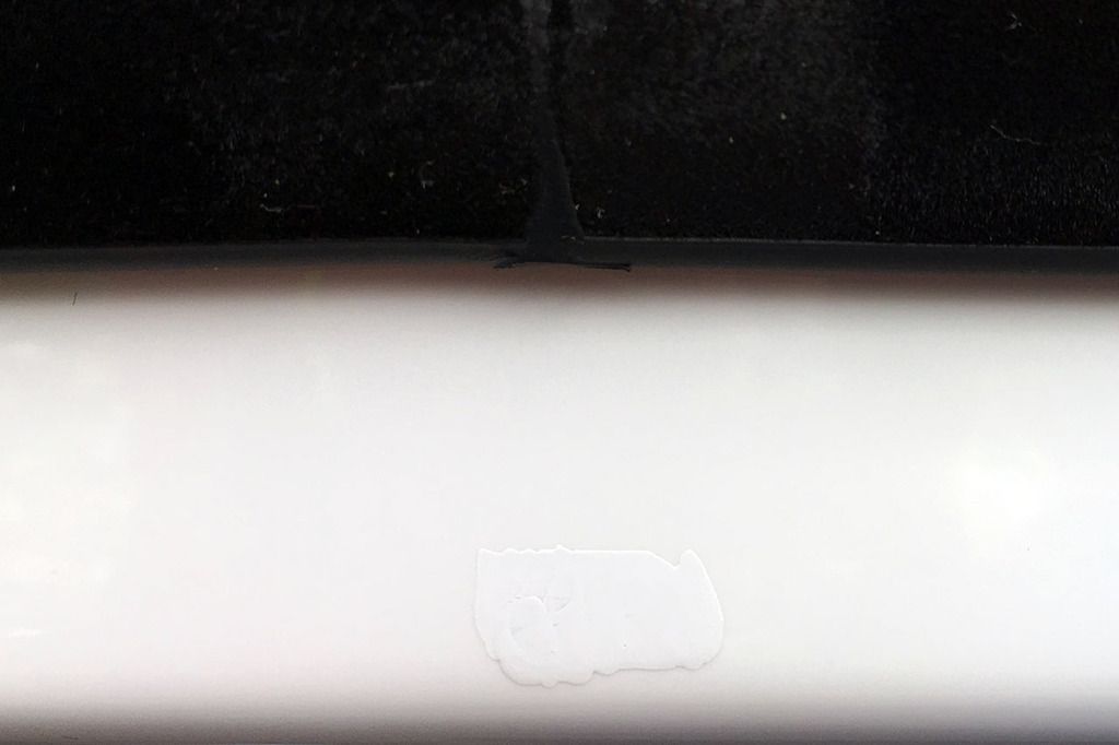

Okay, thought I'd follow your advice and paint a little patch with the Chipex. Here's the outcome. Actually looks too white!! Now, obviously, this was just applied to non-stonechipped area of the paintwork and so it's raised on the original paint. It does look more matte than the original paint but I'm assuming that once you've used the blending solution and polish that this will blend in to the original paintwork a little better?

IMO it looks better than the Paints4U for colour match. The thickness of the test patch (thicker than the original paint) probably also adds to the extra 'whiteness' that you're seeing.
If it was me, I'd apply it to the stone chip(s) you need to touch in, use the blending solution and polish so the repaired area is level with the surrounding original paint and then make a judgement on what it looks like.

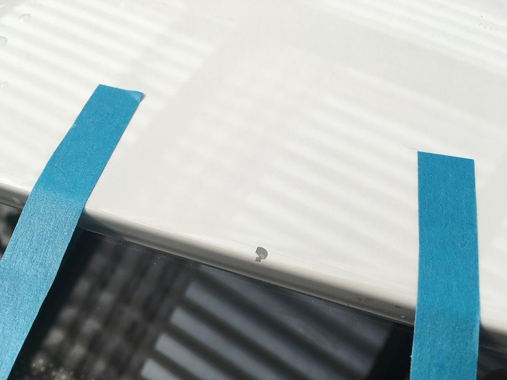

Okay, not the greatest of pics but here's a before and after using Chipex. The match is actually really good but what I just could not do is get the paint level. I tried everything. Only used the tiniest amount of paint, and did this a few times to build up the layers but as soon as you use the blending solution along with the block it just removes the paint!

I had a chip on the front of my bonnet like that. It took about 4 applications over a month to get the paint level. Just keep adding to it after you wash the car for the next few weeks.
