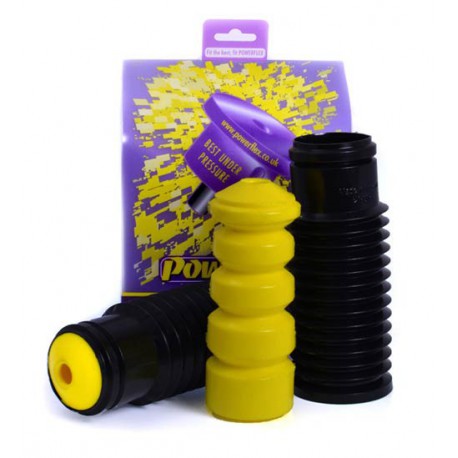

looks like your bump stop has failed , then the shocker has to much travel & gives in
mine did the same , i bought these... http://intermotiv.com/9388-large_default/volkswagen-golf-models-powerflex-bump-stop-kit-rear.jpg
as the originals don't seem to last long.
good luck
