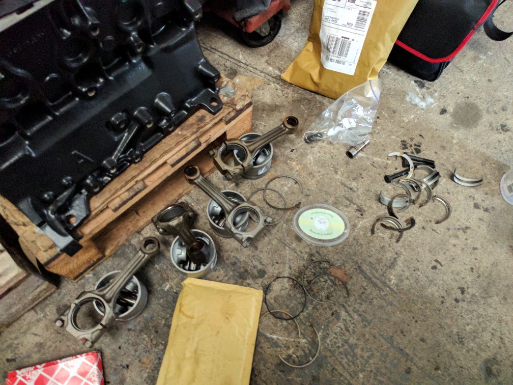

Golf Rallye door cards that came with my leather seats. Finish off the interior very nicely for now. Also got my block and internals back from the blasters:
Really pleased with how they came out. Just got to get round to building it back up and dropping the 1.8 into the bay so she can be enjoyed for the summer. Missed my UD deadline but nevermind. Currently, my workflow looks like this...

I decided that rather than put all the effort into building a 1.8 engine to go in, only to then come back out again and sit about doing nothing, I'll use the rebuilt bottom end with a re-built head from the GTI and but it in the actual GTI as an entire engine rebuild, along with reconditioning the gearbox. I also have lots of spare parts and interior trim left over from the first Golf, so using them to sort this GTI out and get it back up to a better state. Think of it as a driving restoration project to keep the need for a Mk2 in my life at bay. So this weekend I gathered up everything and had a bit of a clear out of the workshop:
So all in, I'm taking the 1.8 litre GTI bottom end, exhaust system, gear linkage and shifter box and spare interior trim away from this Mk2 and donating it to the GTI to bring her back to life. I now intend to rebuild the 1.6 carb engine and get it running so I can firstly certify I know what I'm doing with regards to building an engine and prove it works, before stripping it out and selling it on to make way straight for the VR6/02M conversion. To that end, made a little more progress with the cylinder head off the 1.6:
Pressed in my new valve guides, next stop is to re-grind the valve seats for a perfect fit, rebuild the head up with the GTI cams and put it all back together. I may need to re-borrow the exhaust back from the GTI just to prove it runs but will see how things go. Also managed to strip the pistons and connecting rods right down:
Just need to get new bearings and piston rings as well as a final clean of all the old oil and build up before they're ready to be dropped back into the block. Still working out the finer details of how and when I'm going to manage 3 projects (don't forget about the 6R here) but now I'm living in my own home, with a garage, and working just 9 miles down the road for the foreseeable future, things may start happening again, least for 2 out of 3 of my projects! This one is still in Essex and I live in Dorset now...
