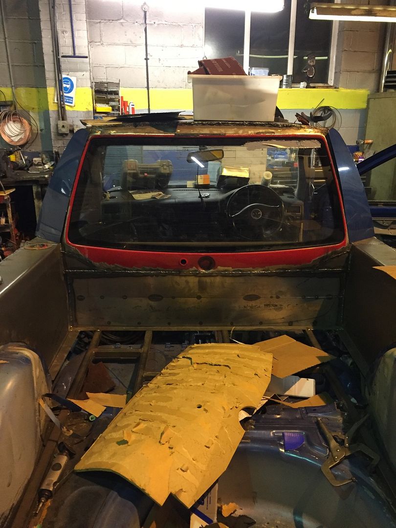

Is that a mk3 tailgate i see?

Yes it is! Great spot. Still can't decide if I like it or not? But no choice now as its welded all the way across the roof and caused me to warp the roof a bit so it's staying now

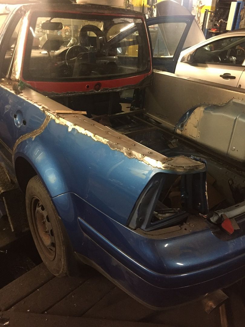

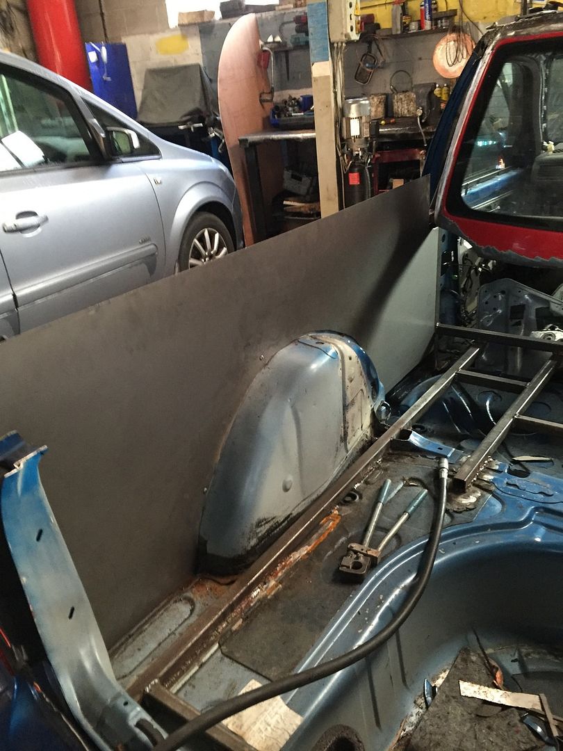

Just another update
Got the bed side panels cut out around arches so I can take some measurements to get them cut on a guillotine to get them perfectly flat for the side panels

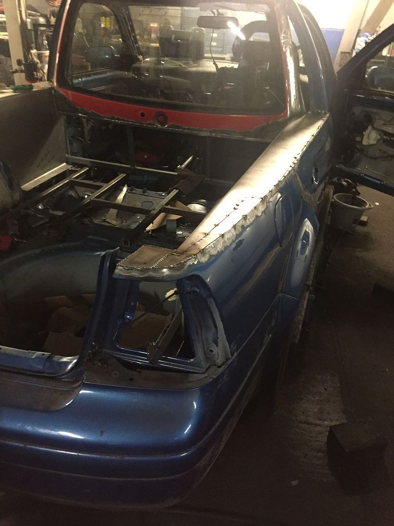

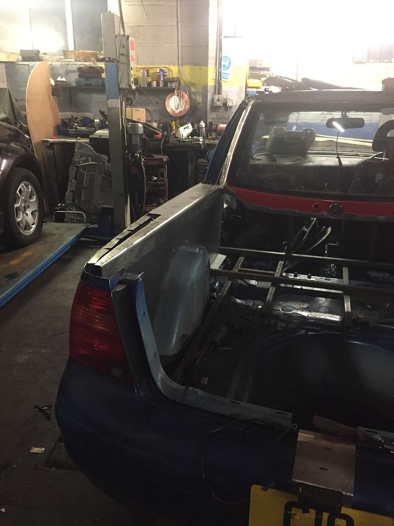

04 January 2016, 18:08 »
Got the sides bent to shape today!
Couldn't decide wether or not to just weld them to the sides/top or put another long flat sheet over the top.
Gone with a complete flat sheet over the top I reckon, give a lot more strength

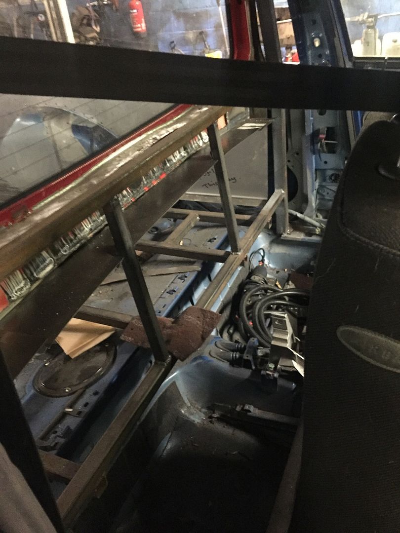

01 February 2016, 21:10 »
Been a while but a few update pics!
I've cheated on you all and bought a mk1 focus RS so finding it hard to not play with that over the bora!

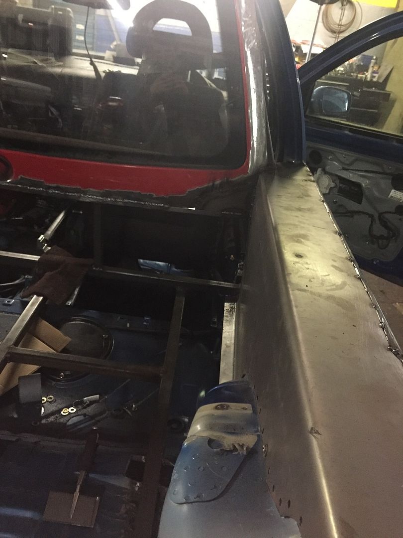

03 February 2016, 20:49 »
Bulkhead almost done!

03 February 2016, 21:31 »
looking good, any idea on weight?
