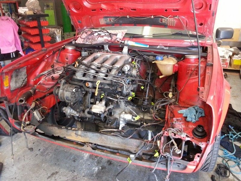

so this is how my car currently looks..
cant wait to get it back, hopefully wont be much longer

little update, the engines in, just trying to figure out a few wires which dont seem to connect anywhere on this new engine, the KR and the 9A must have different sensors  :undecided:

lol weve worked out the KR had 3 water temp sensors and the 9A only has 1, luckily it seems to have the right holes to put the KR sensors in and will see what happens...

little update... shes still not starting, the 9A also has poor compression (100, 45, 75, 100) and the flap in the metering head isnt opening... dont really understand whats up with it.
The head is currently being rebuilt, re-seating the valves and stuff as they did a leak test and there was smoke coming out number 2. Just leaving it in the garages capable hands at the mo  :sad:

yeah that compression is way low. maybe the piston rings are gummed up. the flap wont open unless there is good vacuum from the engine so if there is no compression there will be no vacuum.
