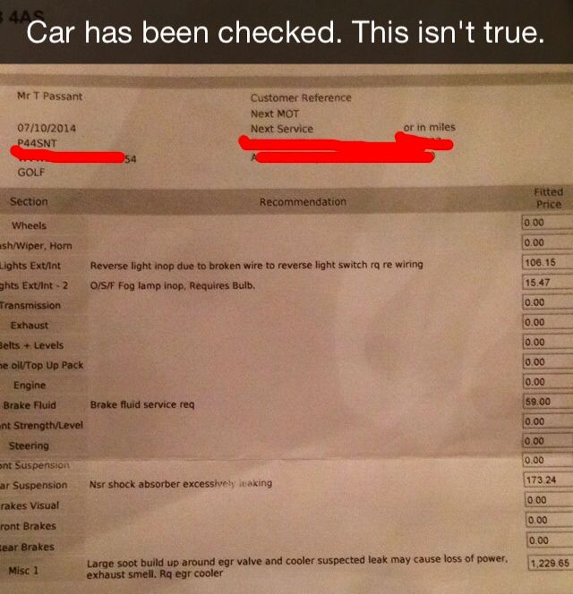

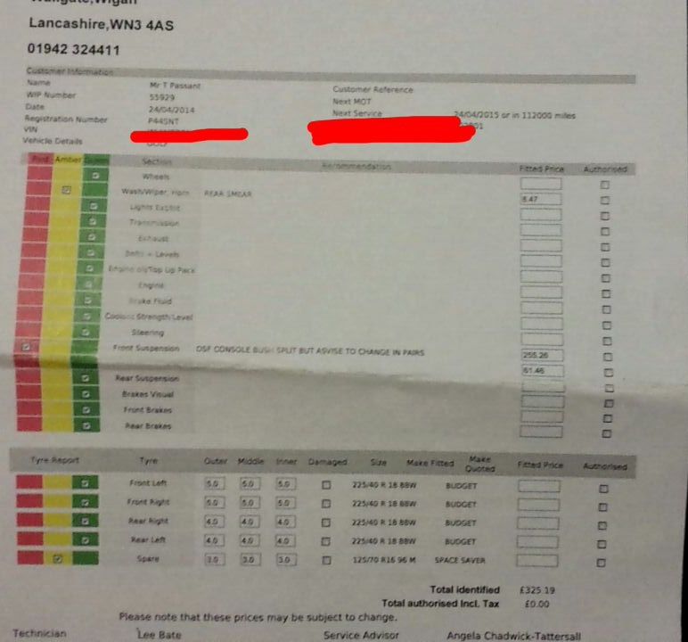

« Reply #16 on: 10 October 2014, 10:52 »
First Picture is the health check from back in April, don't know if you can see or not but the Control bushes are in red and I got told required immediate attention.
Second Picture, the Health check from the other day, I've not touched the Control bush or the rear wiper, and 15000 miles later they have repaired themselves, although Volkswagen have admitted that the mechanic probably looked over this ( not doing their job properly ), or because making up an EGR issue would earn him more money ( in case you didn't know I've discovered they are on health check commision for any extra work they get from the health checks, why do you think they're giving them away for free !?! )

Common problems with a sooted up EGR valve are: rough idle or stalling. Failed emissions test. reduced engine performance surging during cruise conditions possible engine misfire. These would probably throw up P0400 or P0402 code. Your car was performing ok prior to the service?

No engine codes flashed up when VW diagnosed it let alone when I did it, car is running like a dream, and as it always has done, its not in limp mode, no loss of power, and because my car is on the motorway everyday and the DPF is clear, my car doesn't smoke!
I can put a picture on here if needs be of my clear dash, I don't know what on earth is making them think the EGR has gone?!
