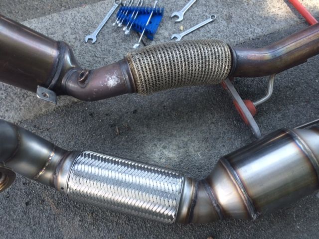

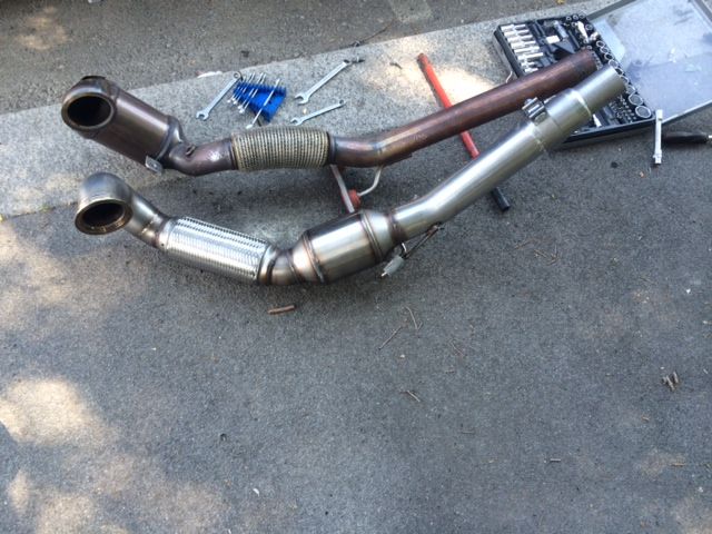

Here is a side by side comparison of the 2 DPs next to the car. As you can see, in addition to the larger diameter and multiple improvements in the various bends, the cat is much further back which also helps flow since the gasses will actually be entering the cells in more of a straight line.
One of the areas that impressed me the most is the sheer quality of the flex joint. The stock one is an incredibly basic accordion design with a bit of protective mesh while the BCS one is a hefty ultra high grade full steel cross woven design. It is MUCH less floppy (downright stiff) despite being slightly longer. Note that some even high end DPs like the milltek have only 10mm flex tubes (half OEM length) and I've seen some reports of them failing.

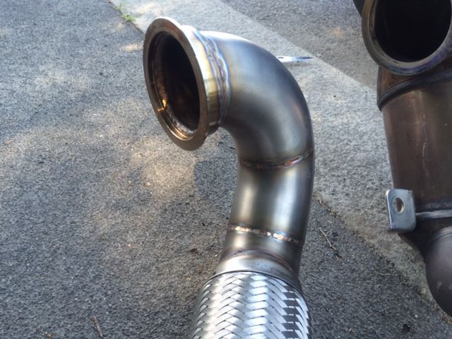

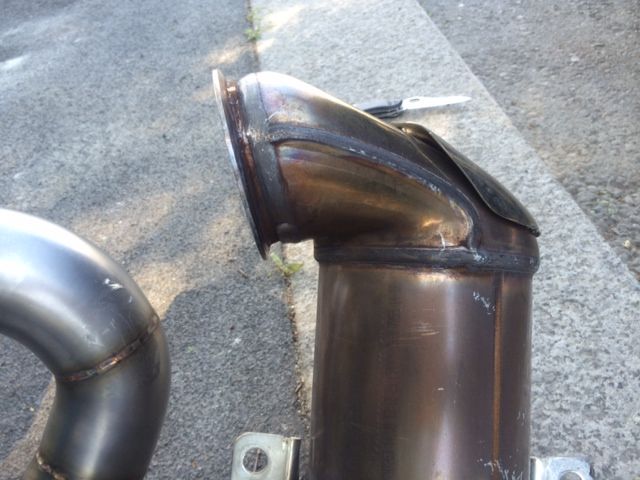

The biggest improvement has to be the inlet. On the stock unit you see an immediate bend of MORE than 90 degrees (110ish?) where the pipe actually flattens (it's even thinner than it appears because some of the already flattened width you see below is heat shielding) and then it immediately hits the 400 cell cat. Not only is the bend horrible, but you're then introducing the biggest point of resistance right after, and the gasses are certainly not traveling in a straight line to enter the cat too. Basically a terrible terrible setup.
On the BCS downpipe, you can see there is a much bigger pipe diameter on that bend and the bend radius is also bigger so the gasses are not hitting a wall head on. Then the cat has been moved downstream almost 2 whole feet so there is way more space for the gasses to cleanly and quickly exit the turbo and straighten out a bit. The cat entry angle is also much better, and helped further bu the fact that the cat would present less than 1/4 the resistance due to the reduced cell count.
