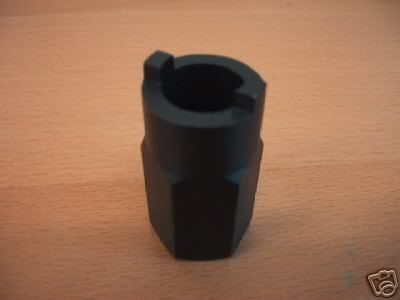

Thats what you need to do suspension... will help you undo the nut which holds the suspension together.. apparently GFS do them pretty cheap. Your also need a special tool to undo the nut which holds the top of the  supsension strut to the car, i use a 22mm socket with a pair of mole grips round it, if the car is on the ground (eg not jacked up) there is enough weight to stop the strut shaft from turning.. Easy hey!
If anyone knows where i can source the right tool, so u can get a spanner in to hold the strut, i'd love to know!
