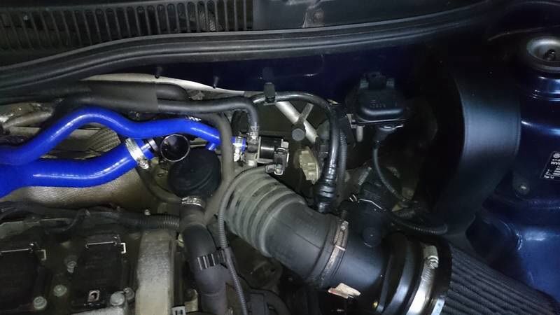

Does this help

is the dv in the standard place is your dv standard

Can you see it mate it's a forge 008

Looks more like a splitter valve to me

Yea I thought that mate the bloke I got it off said it was 008. So what's the difference

008 is a recirc valve a splitter lets some of the air dump out atmospherically to get some wooooosh so I'm surprised you don't have much sound as it is!!!!

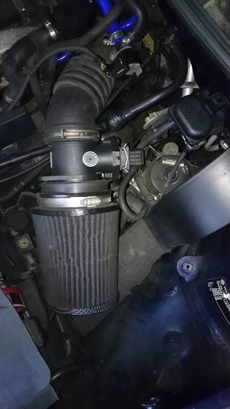

That cone filter looks cheap and nasty - I'd be replacing that with a decent on to begin with.
That is almost certainly a split r valve, it can be changed between a blow off and recirculating valve - you want it to be set to recirculating mode.

How do I do that then. Sorry guys I'm new to this stuff

there sould be a round disc that screws in on the side of the dv
this is where it gose ps you may not have the disc here is a ebay link to one
http://www.ebay.co.uk/itm/Forge-Motorsport-Replacement-Blanking-Cap-Splitter-Split-R-Dump-Valve-FMSPLCAP-/231002498704?pt=UK_Other_Clothing_Protection&var=&hash=item35c8d26690

Yea at the minute there's a trumpet looking bit there shall i put the blanking bit there. What will that do
