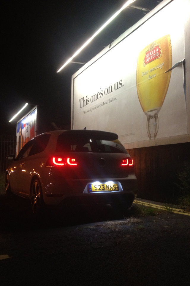

Re: LED number plate lights
« Reply #1 on: 01 March 2014, 00:22 »
I have r dash ones mate! would highly recommend them, give off a nice bright white light with a tinge of blue (which I'm into, not too boy racer-ish!) no error codes as yet, clocked up 12 months with them!
Offline Mattyj
  • Posts: 825
« Reply #2 on: 01 March 2014, 09:46 »
Bit bright for me think the law states no white should be seen from the rear of the vehicle cheers tho :-)
