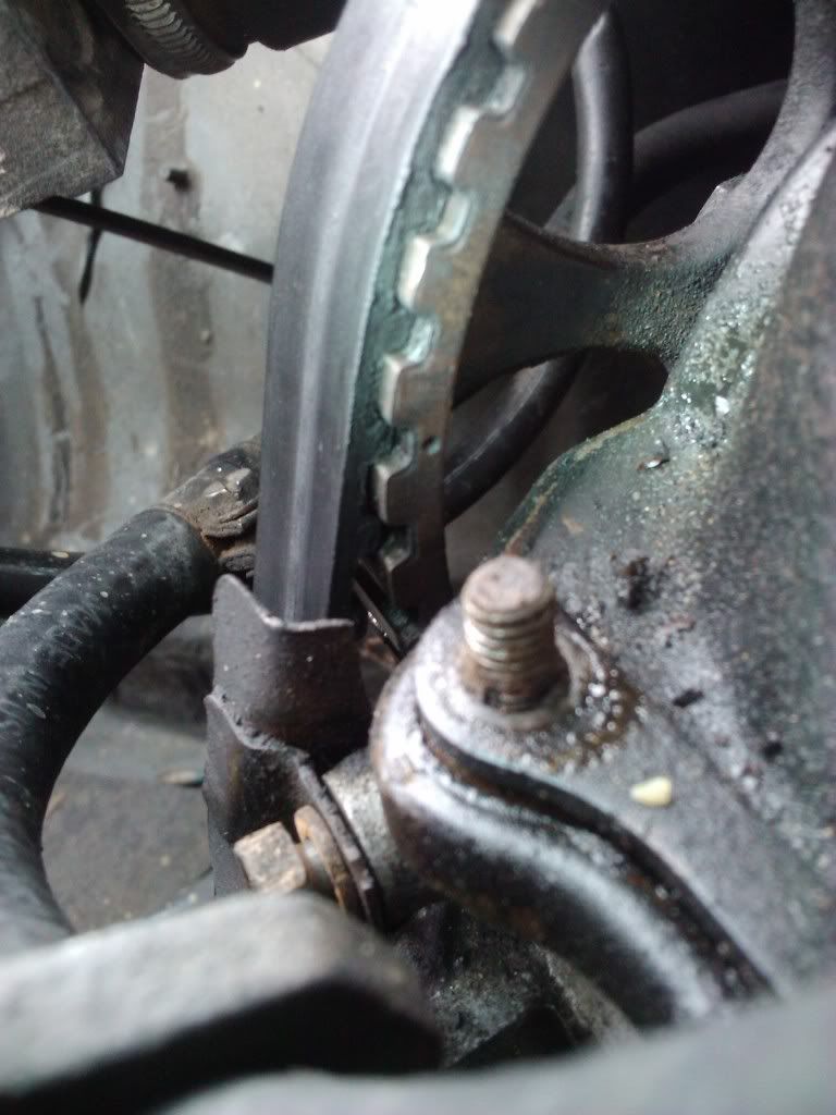

I don't want to worry you but looking at the belt to the right of the picture it doesn't look in great nick. Do you know when it was last changed? Last thing anyone wants is the belt to go. You will be removing the belt from the cam pulley if the timing is out. When you do flip it upside down to face the teeth towards you, then give it a bend. Look for any signs of excessive wear where a tooth meets the belt.

The pic was mine from years ago. Abused that engine for years because it was ruined anyway.
I checked mine cos it felt flat compared to another 8v and as you can see in the pic it was out by a few teeth with everything else timed up. Car ran fine for months just flat until I re did it.

This one should be edge of head at the front with other side of pulley lining up with the O T marks
