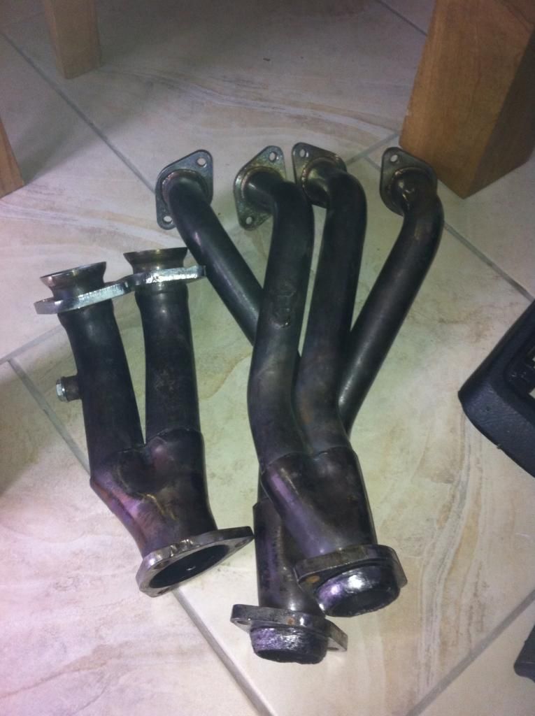

The new manifold turned up today  :laugh:
So the pipe diameter on it is 2.5" and as said before my exhaust is 2" so my question is can I cut the existing pipe off at the rear silencer and weld a 2.5" on? Or would the silencers need changing.

Get a decat section made up (bolts to 3 bolt flange) and then has a 2" end to mate with your existing centre section. Sorted :)

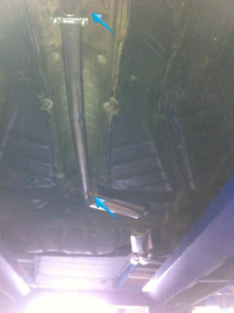

I can buy a metre length of stainless, 90degree bend,3bolt flange and gasket all for under £50.
This is how it is at the mo.
So I was thinking where the top arrow is is where the new manifold should finish and where the bottom arrow is I could just grind off and fit new 2.5" bore.
Dose that look doable.

Buy something like this then just get a joiner between your existing centre pipe.
 http://m.ebay.co.uk/itm/330865186613

Been down to the see the guy that made my exhaust today and he can make me up a exhaust piece that will have a flexy on it and a reducer from 2.5" to 2"
Looking at about £50 dint think that was to bad.
