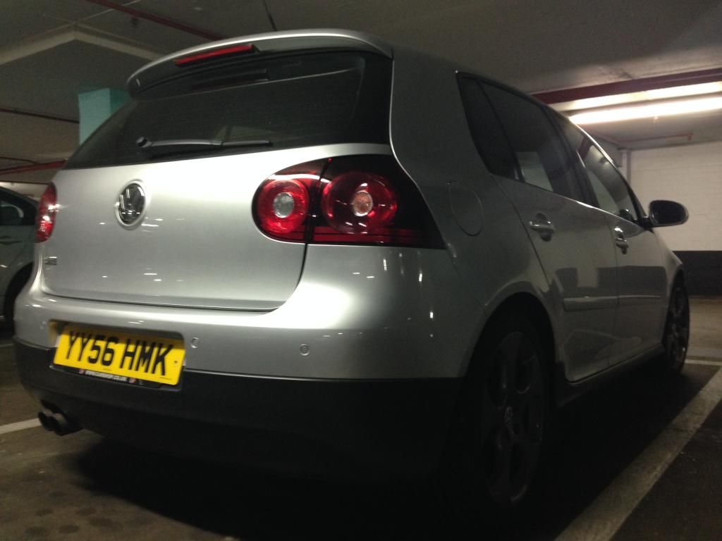

Oooo nearly forgot, picked up the car and 2 days later my first mod :D R32 hellas !

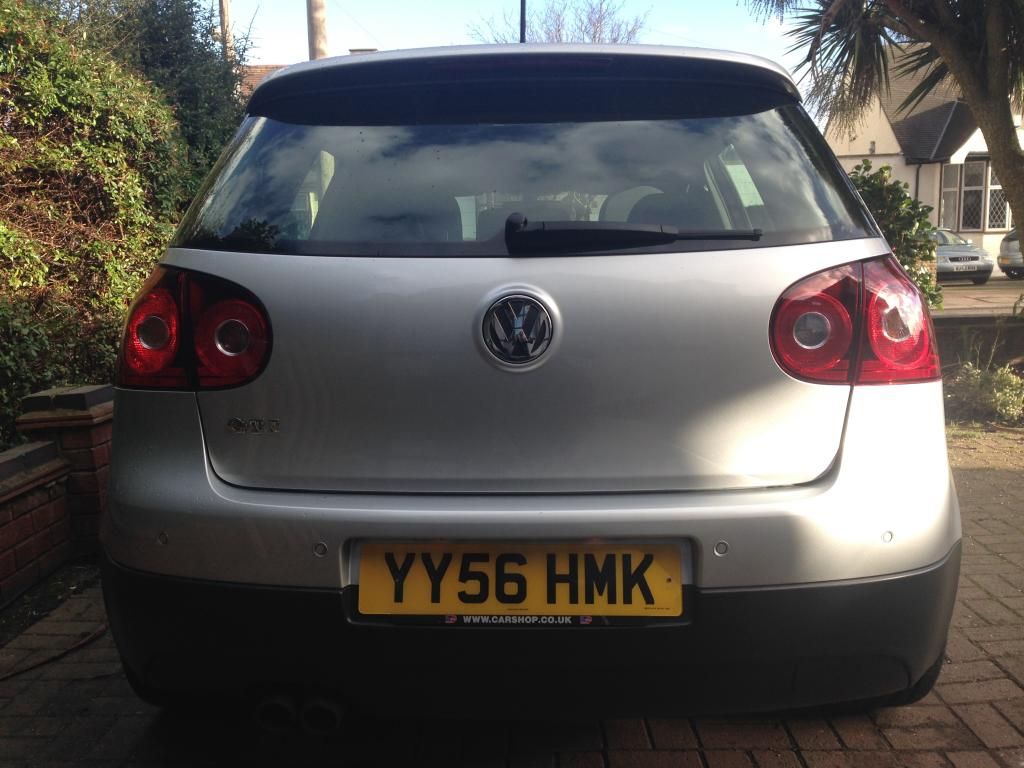

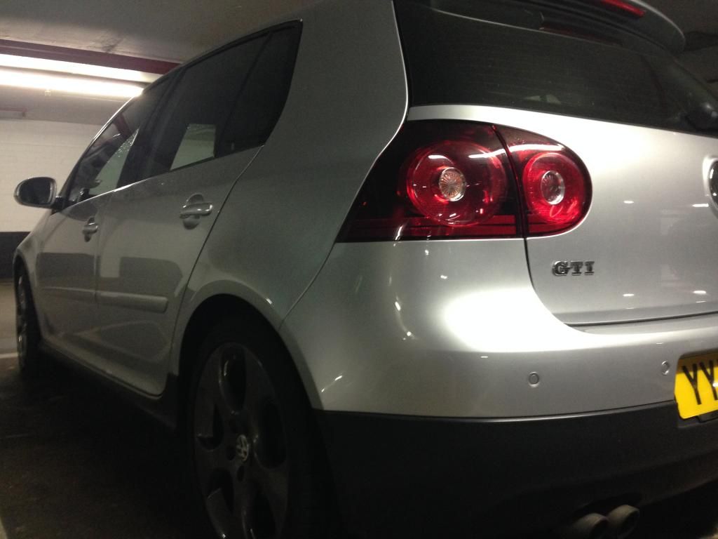

Just thought i'd post a pic of my car with my new colour coded vw badge :)
