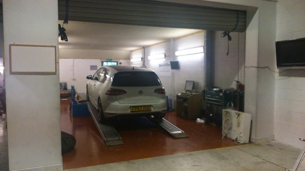

Sounds like only a dyno run will solve this. Anyone got any plans on dyno'ing there 95 RON Gti?
I did mine the other day, made 243bhp with BP Ultimate (Shell was closed due to tanker delivery).
No graph as its a before and after run so wont be getting one till the end of the month. All I do have is this... :smiley:
