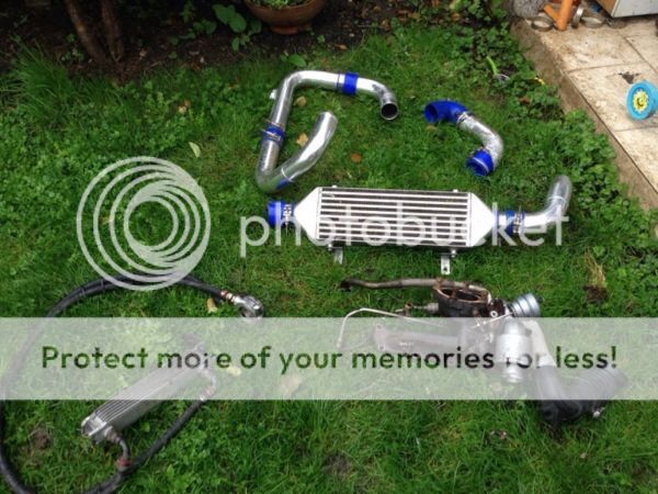

Offline matt@onlychargeddubs
  • Forum Supporter
  • Posts: 105
Re: Intercooler / spec help
« Reply #18 on: 27 November 2013, 09:08 »
http://www.onlychargeddubs.co.uk/products/1-8t-mk4-golf-platform-front-mount-intercooler-and-pipe-kit.html
I do like that, I take it that connects to the existing charge pipe?
From the turbo yes, we we're going to use a Darkside clip adapter but found that it wasn't necessary really, would of bumped the price up and this boost pipe isn't prone to splitting/leaking like the diesels, every other pipe is replaced and MAP sensor is mounted in directly.
It is similar to the THS and Forge ones as there's no other way to make one fit, only difference is that this has full hard pipework, not long silicone pipes (which in our tests and research have proven to be poor quality) or the Forge kit which is all silicone and prone to bulging pipes and making suspect boost pressures, the Forge kit also cuts into the crash bar a lot more that we think is safe.
But even better our kit is cheaper than both :)
Like Dom says, he's been running this kit for a few months now, we've also sold quite a few now and had some great feedback with no updates required on the kit :)

I Might have to sell my Toyo and put my remap on hold till end of the summer and get one, however that's if I can afford it got the misses to pay back and stuff hehehehe.  :rolleyes:
I don't suppose Darkside would consider making up custom pipe work for people like myself and Robbiie_Cee that own the same intercooler that you infact sell located here..
http://www.onlychargeddubs.co.uk/products/universal-2-25-front-mount-intercooler-fmic-540mm-x-140mm-x-65mm.html
I for one would buy it from you, and I am sure others would too and I would be happy to work with you to get the pipe work correct the hardest this we find trying to get pipe work for these intercoolers is the HOT side, it is very difficult getting pipework for the N75 and DV.
