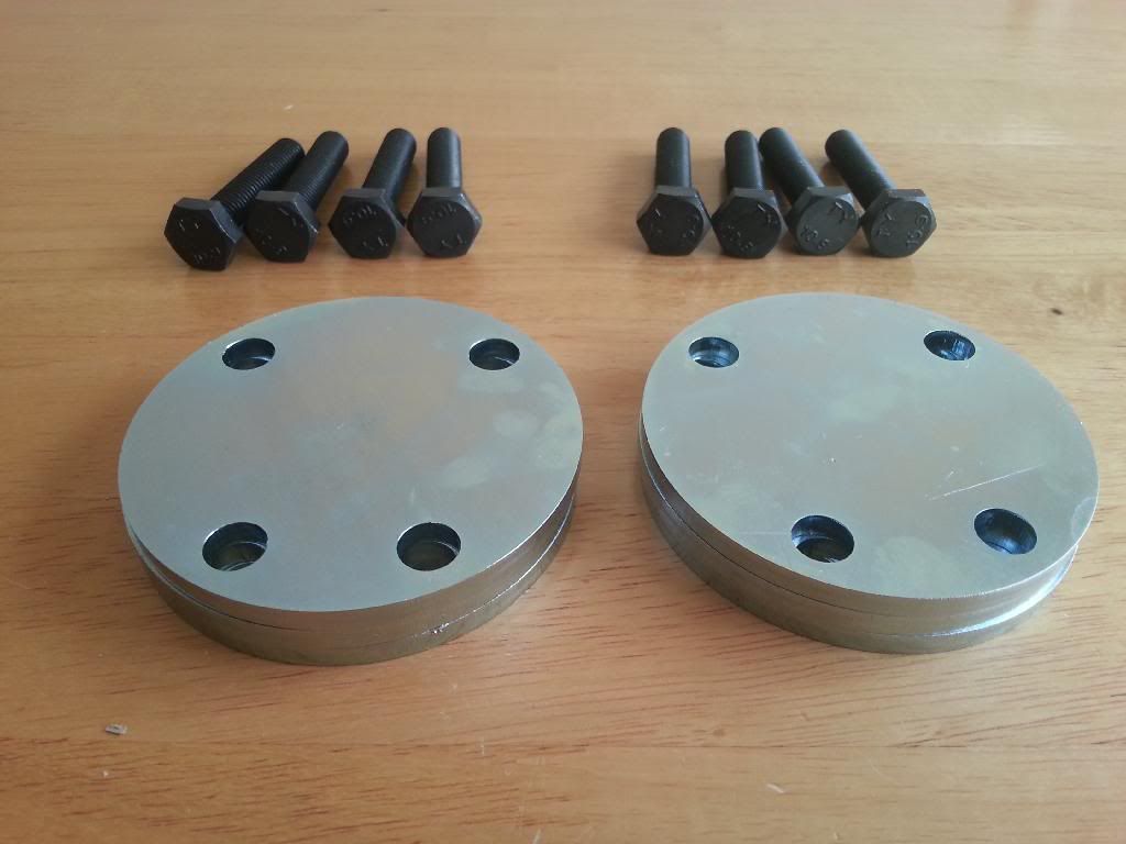

6x 5mm rear axle spacers and longer 10.9 bolts

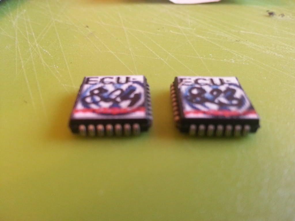

The pair of chips i had installed last week, they required the ECU to be socketed which was seriously out of my league but only £35 to have done.  :smiley:

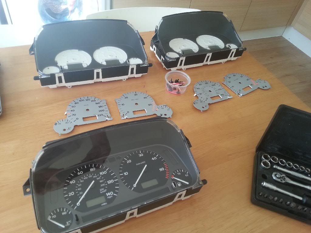

Almost forgot to mention my latest modification which I did a couple of days ago.
As some of you may know, the UK never received a TDI Anniversary and i wanted silver faced dials after having them in my 16v.
Much time was spent searching for alternatives or ways of utilising the European TDI Anni clocks and it all seemed like a major headache at great expnse, especially if i was to attempt to get the MFA display working correctly so in the end i opted to create my own ones by pulling apart 3 sets of clocks, a 1.8 SE set with 140mph & 7.5k rpm, a set of German TDI SE clocks with 220km & 5k rpm, and my standard TDI clocks so that I retained the original odometer reading and correct imperial calibration.
I thought it'd ve rude not upgrade the backlighting whilst i was at it as well. I doubled the amount bulb sockets using a Dremel and installed 4 x LED bulbs instead of the pathetic standard ones.

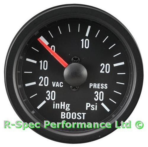

I managed to get my boost gauge fitted today though which took some fettling to get sitting correctly in the vent pod due to the depth of the gauge plus wiring &  hose. Mr dremel came out to play again and chopped a small section of the vent housing away but it was still bloody tight as i wanted to retain a functioning vent flap.

It appears to be working well and boost is peaking at about 18 psi, I swapped the standard back lighting bulb to a green led but after driving it this evening im unhappy with its appearance as the green is different to the dash lighting and much brighter so this will need addressing promptly.
